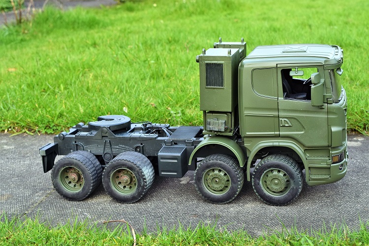

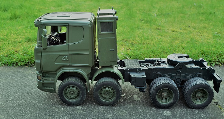

Hi All see attached a converted 8x4 Scania to RC done by a freind JB in Wrexham I did the paint job just need to convert & extend the lowloader trailer to take my Challenger 2

I’m all for tank transporters but for a Scania hauling a challenger 2 in the uk shouldn’t it be a 6x4 top line, blue and say metcalfe on?
Anyway good conversion. Look forward to seeing the full set up
