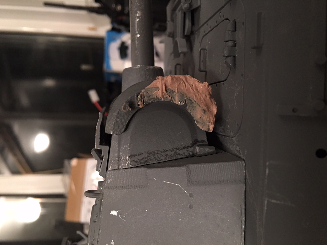

That's a good solution, what I made very unclear was the driver and radio man would be trapped if the tank was knocked out with the turret chin over there hatches at about 30dgr the chin of the turret would block one of there escapes, I can't imagine they would have let that happen? Or maybe it was a stop gap measure, so it was better to not get killed by the mantlet shot trap, but take a chance the tank didn't get knocked out with the turret chin over one of there hatches?
The mantlet, and the mantlet attachment seem too big, thick??

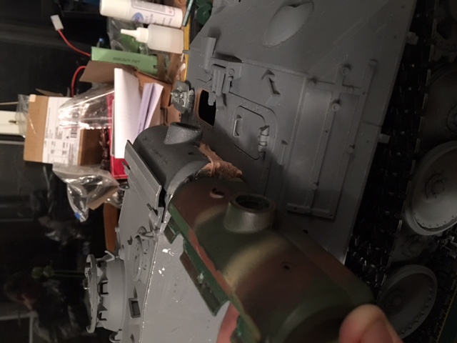

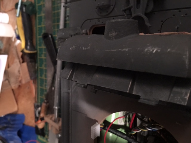

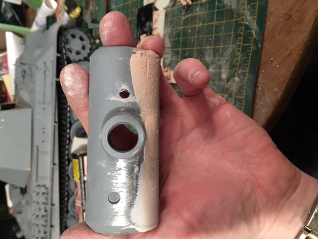

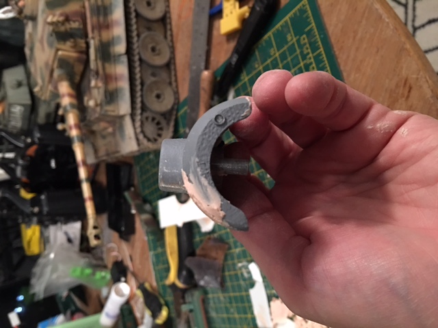

I've worked out why it's too big, the heng long one is right, the mantlet attachment is the right size to fit the mantlet without it failing the hatches, the rctank one I think to get the metal rain gaurd detail to attach with pegs into massive attach points (which is too thick anyhow!) the factory have made the metal mantlet attachment 5mm bigger than it should be, the mantlet is still too thick at the chin, but the bigger attachment pushes it out completely.
I'm turning it into a early g, without the chin, guess it meant I can zimmermit it! If I'd have realised this sooner I wouldn't have butchered the plastic heng long one.
I spoke to the great man Dominique and he say they took it from the plans at munster tank museum, I'm thinking the factory might have fiddled with the cad files to solve the rain guard.
In pencil the extra bit to accomadate the rain guard

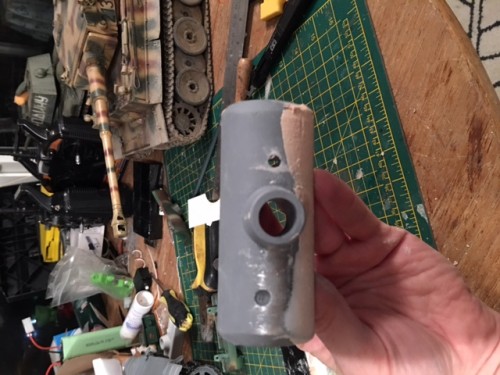

Metal
Metal
Comparison
Comparison

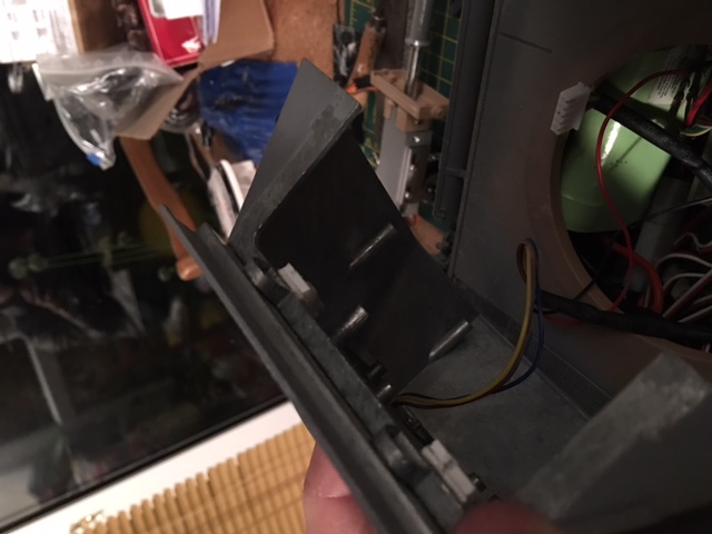

Rain shield
Rain shield

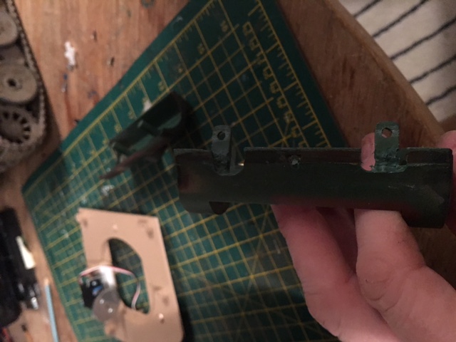

Heng long pre mantlet??

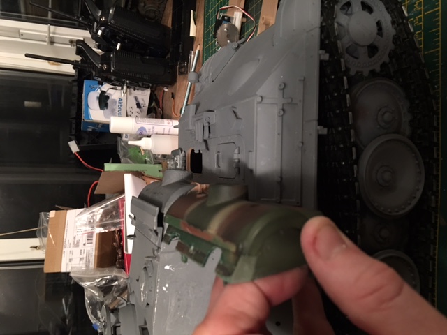

Man, I wonder what crews found out first! I'll stick a pic up if I manage to get the mantlet to look right after tons of car filler!!

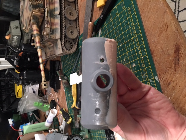

Think this is nearly there
