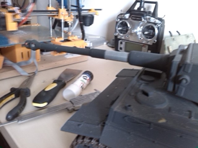

I took a saw to the BB barrel, and printed an extension piece. It is reinforced on the inside to keep it all aligned.

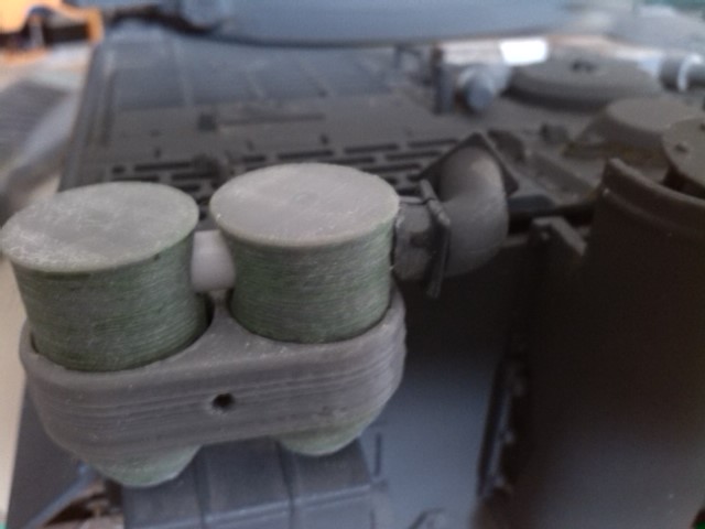

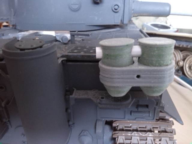

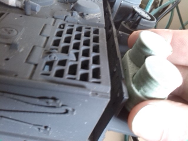

I have also spent a great deal of time designing the early Feifel air filters, they are in several parts that all go together, plus I am using styrene tube and some of the original mouldings. The green that you can see is the filler that I use to infill the ridges that 3D printing inevitably produces.

It took a few designs and redesigns to get them ok, I am also using an ancient reel of filament that I was going to throw away, but it is worth using up on a test project like this.

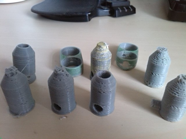

If and when I get around to buying fresh filament I might think about running a few off for those that want them. I looked at the sprue and it was $29? so thought that I would give this way a go. Each part takes around 30-90 minutes to print? I might upload the designs to Shapeways and see what they charge to print them, they would be much higher quality that way.
This is what I had to test to get the parts the way that I wanted them. I just need to stick some styrene tube in the bottom of all four, I have some 12 sided twisted hose on the printer at the moment...and that is taking forever... :/

Well the damned hoses are proving a challenge using the 'past its sell by date' filament. Printing hollow tubes forces the printer to move the print head away from the tube between layers to allow the filament to cool, and printing it solid prints too hot and causes the filament to mess up. There is a solution but I am giving it a rest and will tackle it later.... @)

Fixed the horrible hose printing and produced four of them. One side is almost done, I can do the other side tomorrow.
The light makes them look worse than they are, but they are 12 sided, and will look like hoses by the time I have finished with them.
