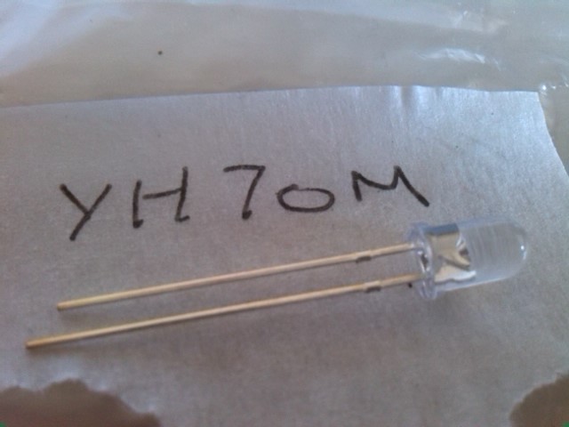

1 x IR emitter. The same spec as this one. This is what I use:

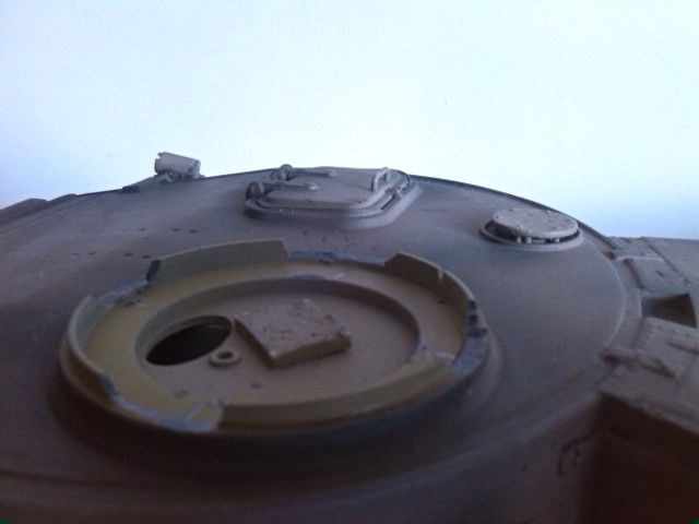

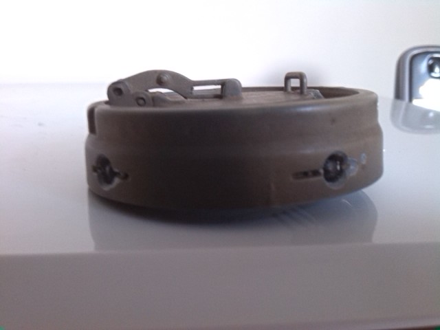

I will use a Tiger 1 cupola as an example of how to hide the sensors.

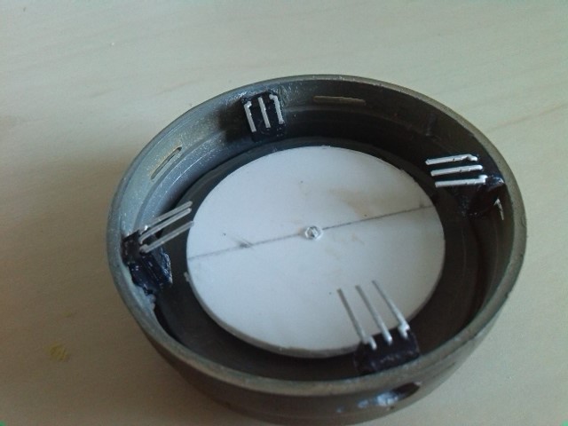

Drill 4 holes around the cupola. In this instance the cupola hinge has to be facing in a certain direction, so make sure that the holes are facing forwards, backwards, left and right.
To leave room to get the cupola on when the sensors are behind it, I needed to carefully remove a part of the retaining lip.
The wiring for the sensors will be directly under the hatch, so to allow a commander to be glued in place, I cut a circle of styrene and glued that under the hatch.
Then carefully glue the sensors in place, and trim the legs back.
Ok, that's the sensors all mounted.

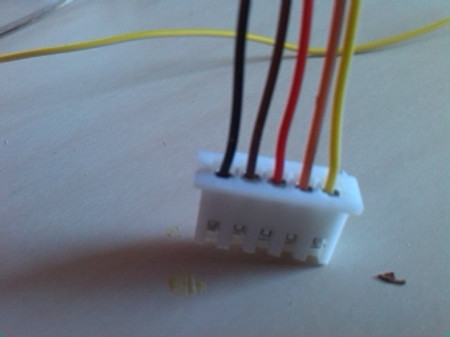

Next I need to attach the wires.
The Clark site shows the pins 1-5 on the 5 pin IR socket.
What he has also done is describe the pins in the table underneath in non-standard terms.
You wouldn't have a clue how to wire IR sensors using his description.
This is what you need:
Clark board 5 pins described in correct terms
1 VCC Black
2 OUT Brown
3 GND Red
4 LED- Orange
5 LED+ Yellow
TSOP 4838
1 OUT Brown
2 GND Red
3 VCC Black
LED's
4 LED- Orange
5 LED+ Yellow
Emitter (Seperate plug with Green/Black wiring)
1 LED+ Green
2 LED- Black
Clark supplies a 5 pin plug as an optional extra with the colour coding as shown above. He also supplies the mini-plugs for the muzzle flash led, and the IR emitter, these have green/black wiring.

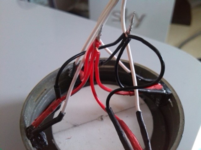

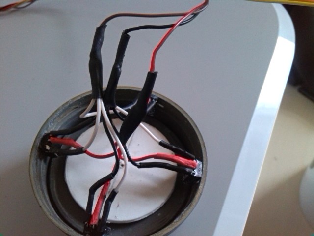

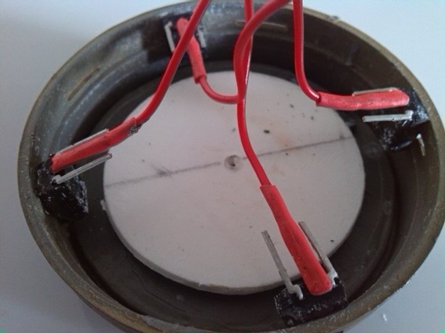

The next stage is to solder the wires onto the sensors.
I did the middle one first. This is the GND pin.
I used red to match the wire that goes to the plug.
One length of wire on each sensor.
Heatshrink on the solder joint.
I did the right one second. This is the VCC pin.
I used black to match the wire that goes to the plug.
I did the left one thirdly. This is the OUT pin.
I used white. It should really have been brown to match the wire that goes to the plug.
So, now we have all the sensors installed, and three wires soldered to each one.
Now I simply twist each set of four wires together and solder them to keep them twisted and secure.
Now we only have three sets of wire coming off the four sensors.
These can be soldered to the wires from the plug.
Red to red.
White (pretend it is brown) to brown.
Black to black.
That's all of the sensors hooked up.

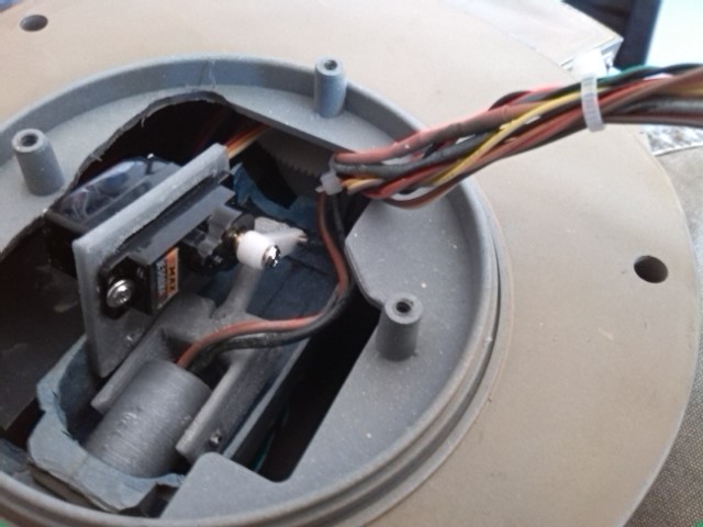

Just thread the plug down through the bottom of the hatch, depending on the tank, you may need to drill a hole. The Tiger already has a BB hole, I just drilled a hole underneath as well, in the BB chute.
Part 3 will cover the 'Hit' led's.

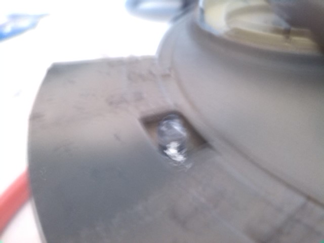

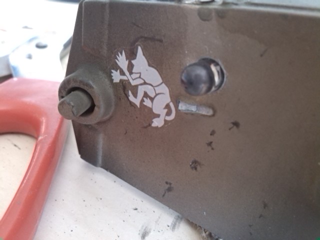

Installing 'Hit' led's.
You can put these wherever you want, and you can have just one, or up to four.
Use 5v ones, any colour.
They can be 3mm or 5mm dia.
In this case, I am superbright 5mm 5v ones.

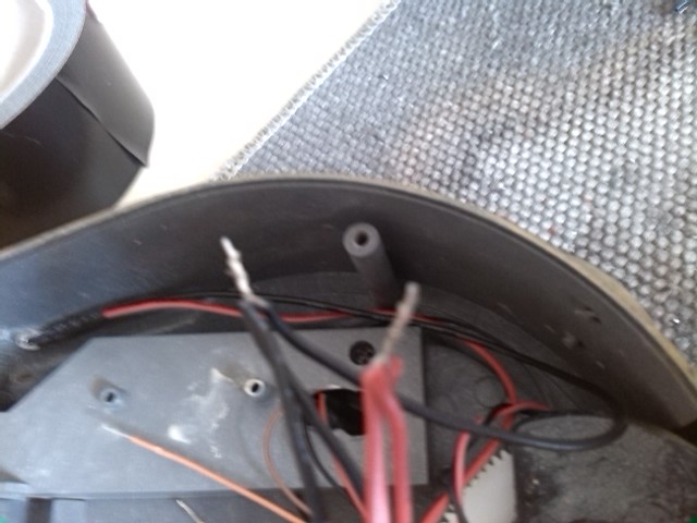

I am only installing three, as I can hide three, but not four.
One is in the recess in the rear bin.
The other two are behind the smoke dischargers.
These came prewired. If you are wiring your own remember that all led's have two legs.
The long leg is + positive, the short leg is -negative.
You cannot blow an led by getting the polarity wrong.
You can blow an led by using a 3v led on a 5v power supply.
Take all of the positive wires and twist them together.
Solder them to stop them unravelling.
Take all of the negative wires and twist them together.
Solder the orange negative wire from the plug to the black negative wires from the led's.
Solder the yellow positive wire from the plug to the red positive wires from the led's.
That's all of the battle system wiring done, and all connected to the 5 pin plug.

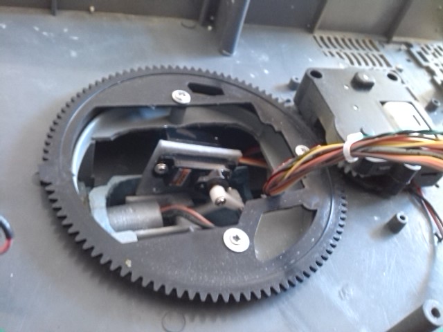

Now tidy the wiring up using cable ties, self adhesive clamps etc. You need to make sure that once the turret is reassembled, no wiring is going to get trapped in the turret rotation gears, servo's etc.

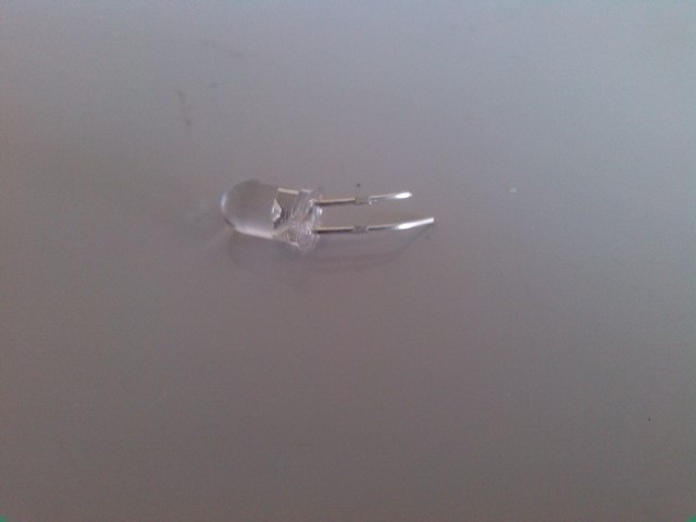

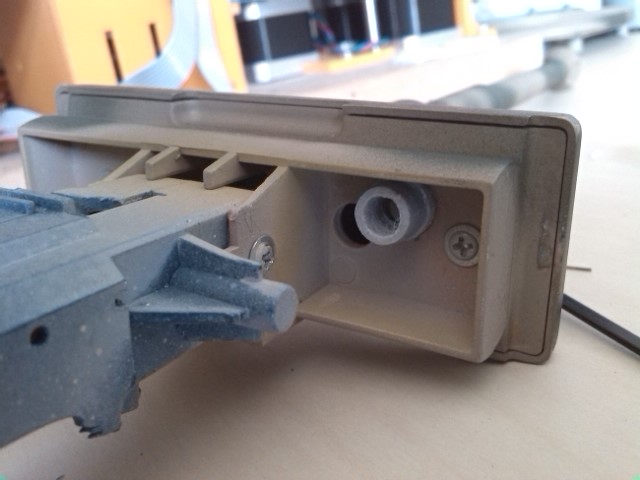

Last part, installing an IR Emitter:
Depending on your tank the emitter can be installed in all sorts of places.
It should be mounted so that it follows the barrel elevation and traverse.
The Tiger has a handy hole in the mantlet, so I am using that.

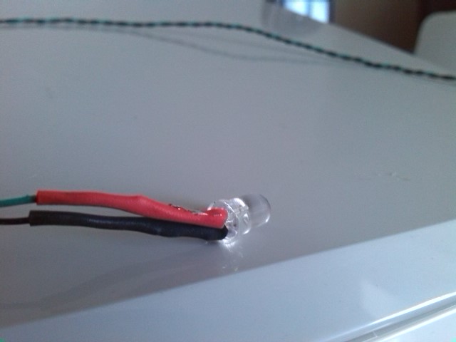

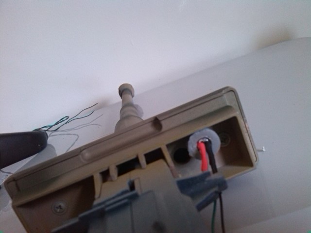

The led must be mounted in a tube.
The tip of the led must be 9mm from the end of the tube.
A 17mm piece of styrene tube is about right.
In my example the mantlet is quite thick, so I have simply added a shorter tube inside so that I get the magical 9mm length.
Same rule as before for soldering +/-, long leg, short leg.
If using a Clark board solder the black wire to the short leg and the green one to the long leg.
I made a clamp, so that if the led blows (very unlikely) it can be removed very easily.
All installed
