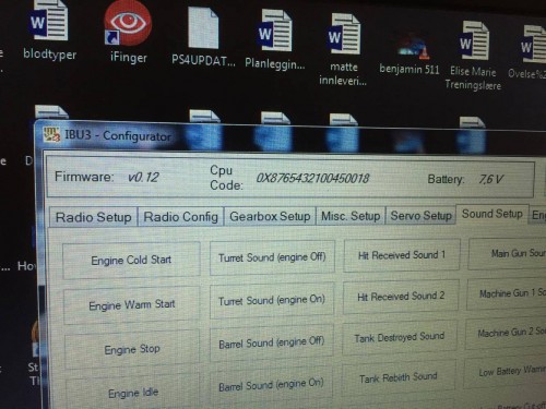

Download the
pc_software_v0.12___drivers.zip
from here :
http://www.rctankelectronics.com/ibu3.html
unzip it so that you have the 'DFU' file , and plaze it in a folder ore any Place you like /remember on the computer .

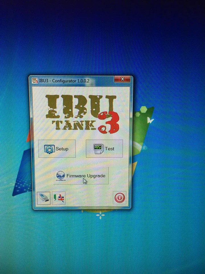

Fire up the ibu configurator ( Connected to the PC ) and press the USB icon and choose COM port , to Connect it the computer .

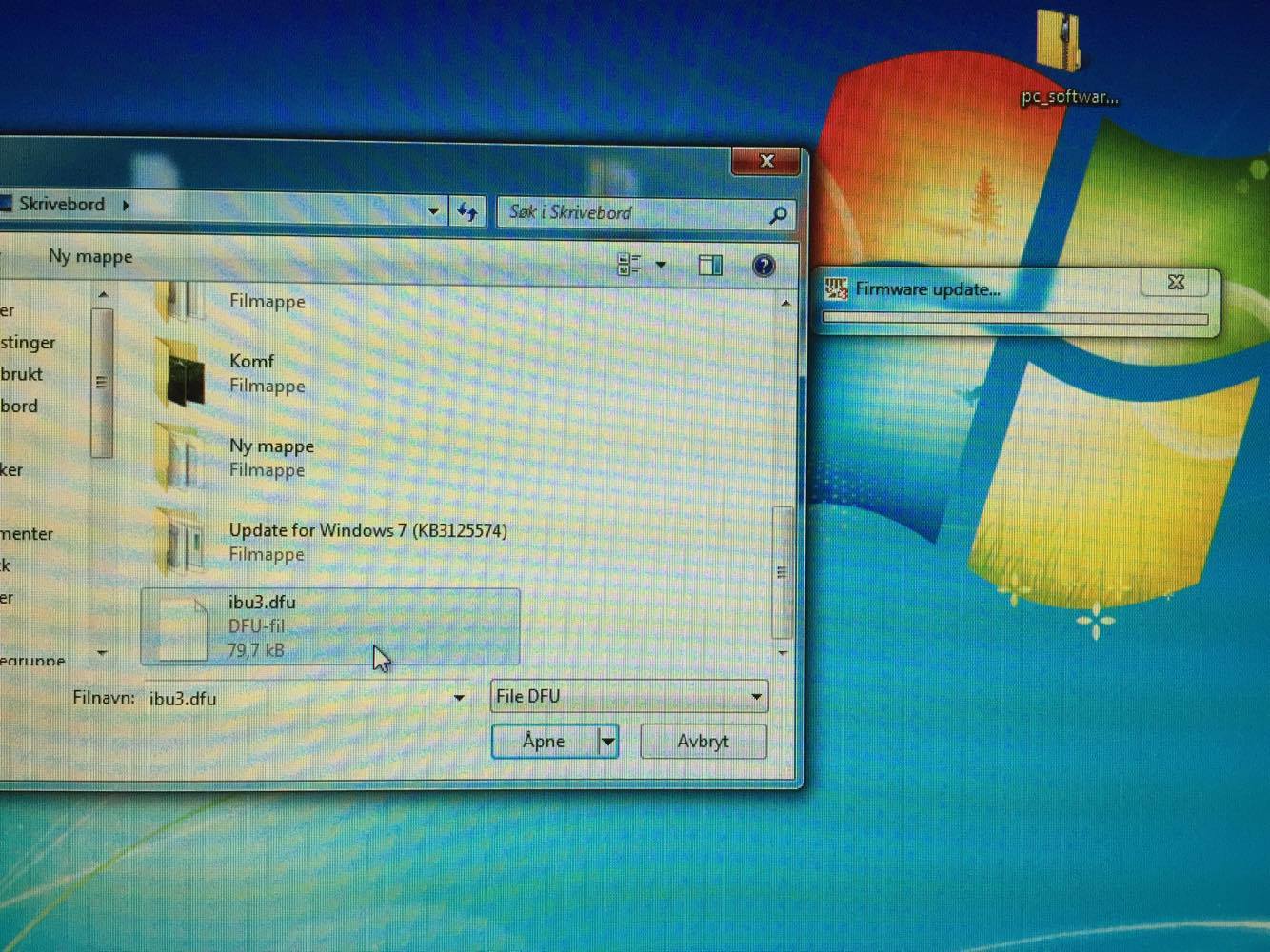

press the firmware uppgrade button Find you're way to the uppdate DFU file you stored and Open ore dobb click on it , and the small update prog will do the rest
