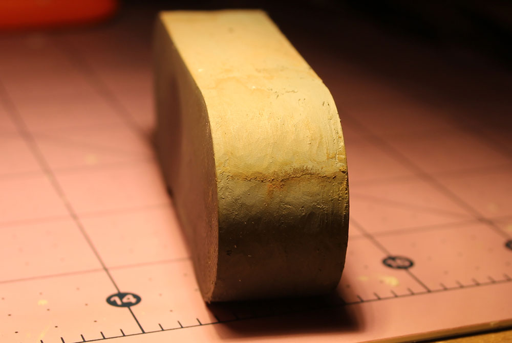

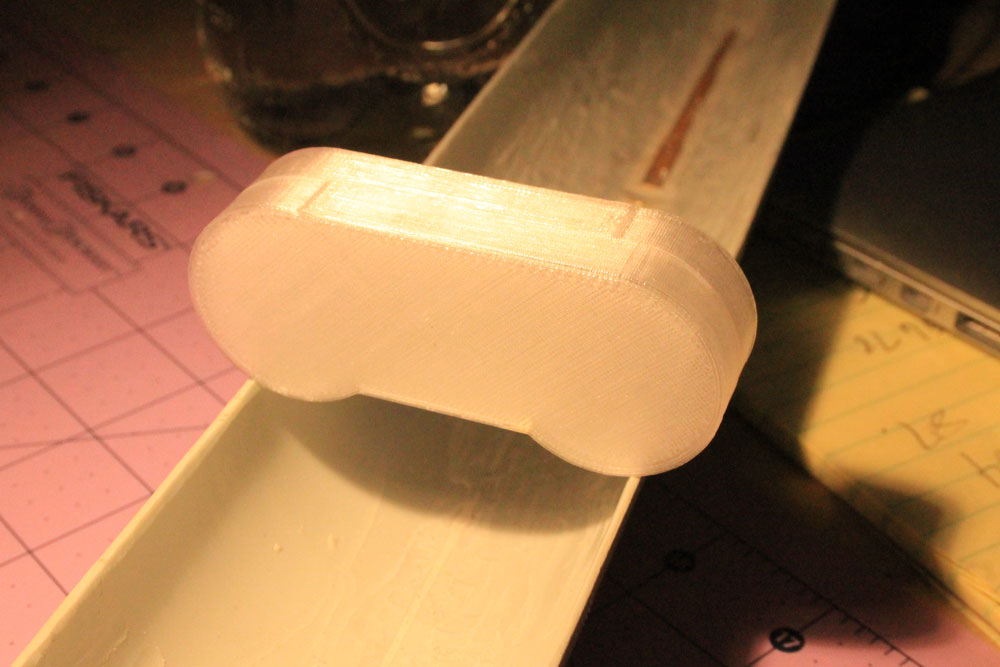

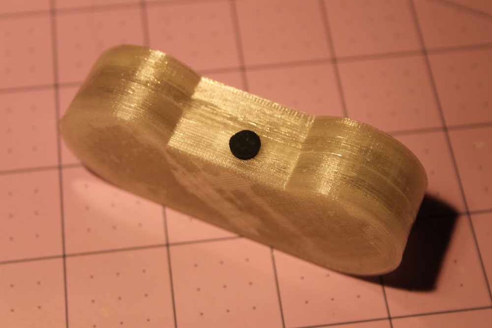

Re: cheap 3D printer
Hey Tom,tomhugill wrote:Would love to see your 3D printed ballast tanks ausf
Here ya go. This was the proof of concept I did to check for watertightness, etc. It's two pieces epoxied together with an insert to key it. The real one will have the exact dimensions of each section of the Revell kit, I'll add a system to secure it to the lower hull and will have a cutout for a small WTC that will house the lipo, APG and Rx. I'll also have a watertight housing for the valve/pump control servo in the design and the detail for the top of the pressure hull.
This has been filled with water for over a week without leaking.
I'll print it in sections and build it like a modular home. That's what's so cool about 3D printing, everything is square and matching. I did this as a test of material. It's printed in PETT, the same material water bottles are made of. I wanted to make sure it was sturdy, paintable and I could texture it with dents and 'oil canning' that the U-boats were subject to at depth.
Yes, PLA doesn't need a heated bed, but it sure helps. And any material past it like ABS, HIPS, etc does, so why waste the money on a printer that you may outgrow in a short while? I print directly on a sheet of PEI, no glue, tape or anything, the bed is always on, just different temps for different materials.
