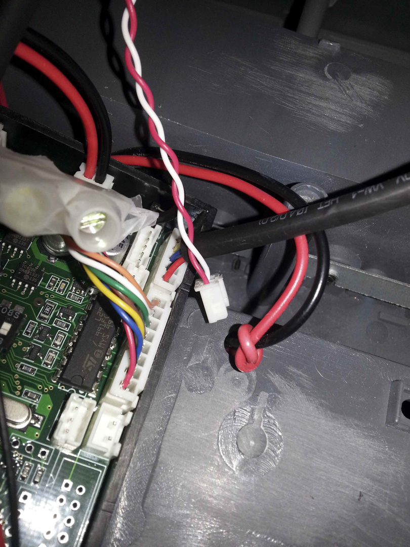

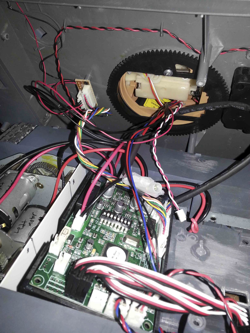

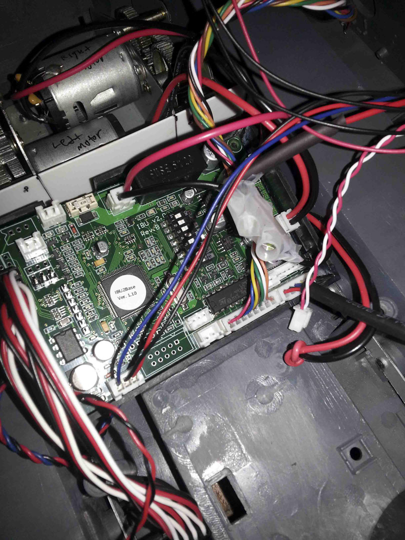

I have fitted the Taigen IR turret with recoil to my Heng Long tiger 1. After I turned it on first and my 2amp fuse blew I got more 2amp fuses.
I rewired the board and turret etc and the tank with run fine apart from the gun which will not recoil, the gun flash does work. I have noticed I have a spare lead with a red and white from the turret but I can't figure out where to connect it on the IBU2 base version I have.
I have tried to upload some pictures but it's my first time trying to upload pics to a thread so I hope they are visible.
Any help is appreciated as I am not sure if I have made a mistake or it is something else.

There is a switch under the hatch which turns off the recoil is it that?
Also there is a thick wire probably red this needs connecting to the battery negative.
The red white wire you mention isn't used, flash needs rewiring to 3 pin plug like in manual.

Oh dear this is a tad embarrassing but yes it was the switch on the hatch
Still got a bit to learn it seems

I just wish to thank you for your pics, I to had got myself the tiger 1 all metal turret with flash and recoil. I had an idea were the wires would go on my IBU2. And thanks to your pics it had comfirmed it. just now got to sort the slight delay on the recoil LOL but thats for another day.
Thank you again it was a big help
