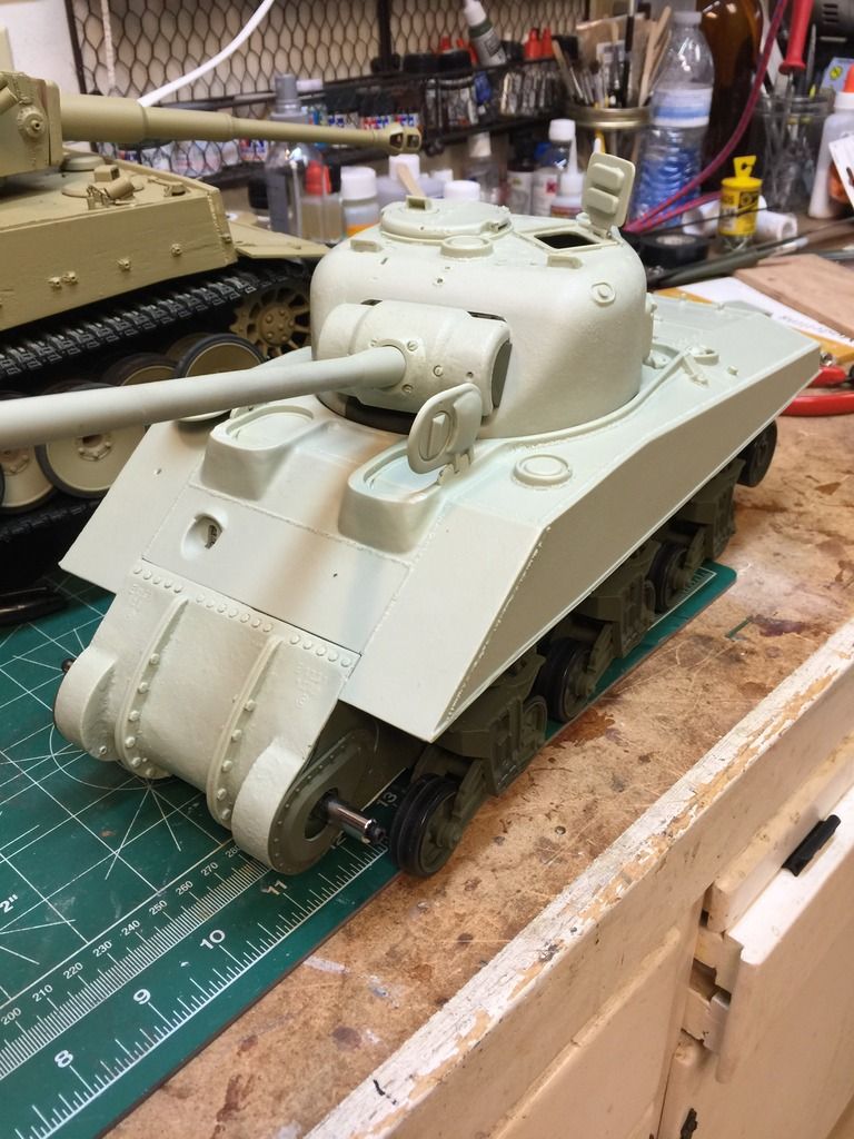

Quick question, been working away today got the HL gun, elevation etc in. Now lower part of turret
Won't close on left side. Does the turret elevation unit need lowering ? Or did I make a mistake?
Cheers Mark

Mark, if you are using the side elevation unit (i.e. Stug/Panther unit) with the Heng Long mounting plate you need to either lower the mounting posts, or trim down the single pole that holds up the mounting plate to get the right angle so that bottom plate will fit properly.
Of course this is assumming that the bottom part was fitting tight before you mount the elevation unit. Otherwise it could be the mounting posts for the turret bottom as I have to trim them down a bit as well.

Thanks Michael it was just too tall :{
My first time with these resin parts.
So here she is after several hours spent
Working on it today. Gun and turret elevate and rotate
I think I have wimped out on stretching the hul for now :haha:

Slowly moving along with this one. Swapped the headlights from the HL
And got a bit of primer on it :thumbup:
