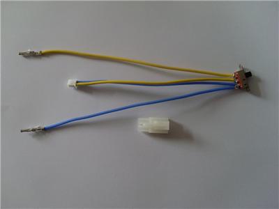

forgebear
Posts: 1848
Location: bedford
Re: I am so confused now....
Post by forgebear »
wibblywobbly
Posts: 6396
Location: South Wales Valley
Post by wibblywobbly »
Dave snuck that in there while I was typing :haha:
His pic shows the HL solder monkey method, it will also work that way
eg
Empty...Empty
Bat +..bridged across to...Board +
Bat -...bridged across to...Board -
The difference being that you will need more solder and more heat to do it that way.

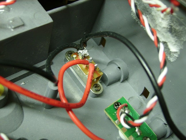

forgebear
Posts: 1848
Location: bedford
Post by forgebear »
yer not the best job
lol but you get the point
dave
forgebear
Posts: 1848
Location: bedford
Post by forgebear »
this might help to
