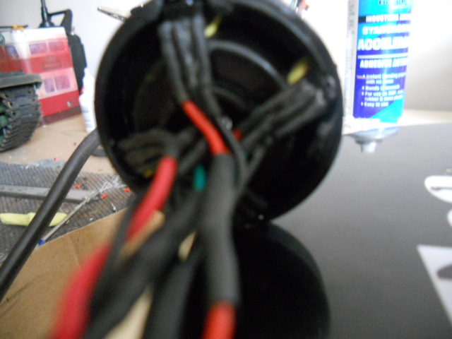

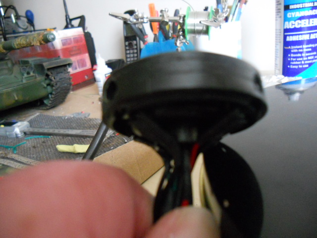

I had a quick play around yesterday and had a go at hiding the sensors in a Bulldog/Pershing road wheel. They are hollow behind the rim so it seemed a handy place to put them. I just drilled four holes around the 'rubber', and then dremelled out enough plastic to slide the sensors in so that the raised domes were showing through the hole. I then drilled up through the hub centre to fit the flashing led.
There are three wires on each sensor so I used the same colours on each one, and then soldered each colour together. Then I just soldered a single wire in the same colour to each of the combined ones, so I only have three wires going down to the 5 pin plug on the board. I will also have two wires for the led.

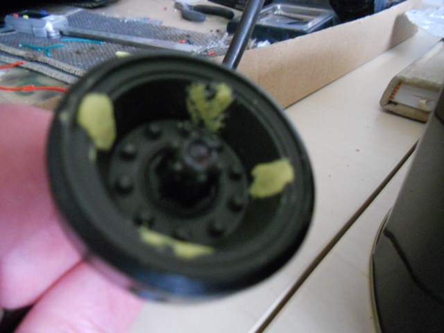

I filled in the back with milliput, and just have to sand that down and paint the wheel, it will then go on the turret roof of the Chieftain and not look too much out of place.
