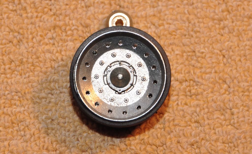

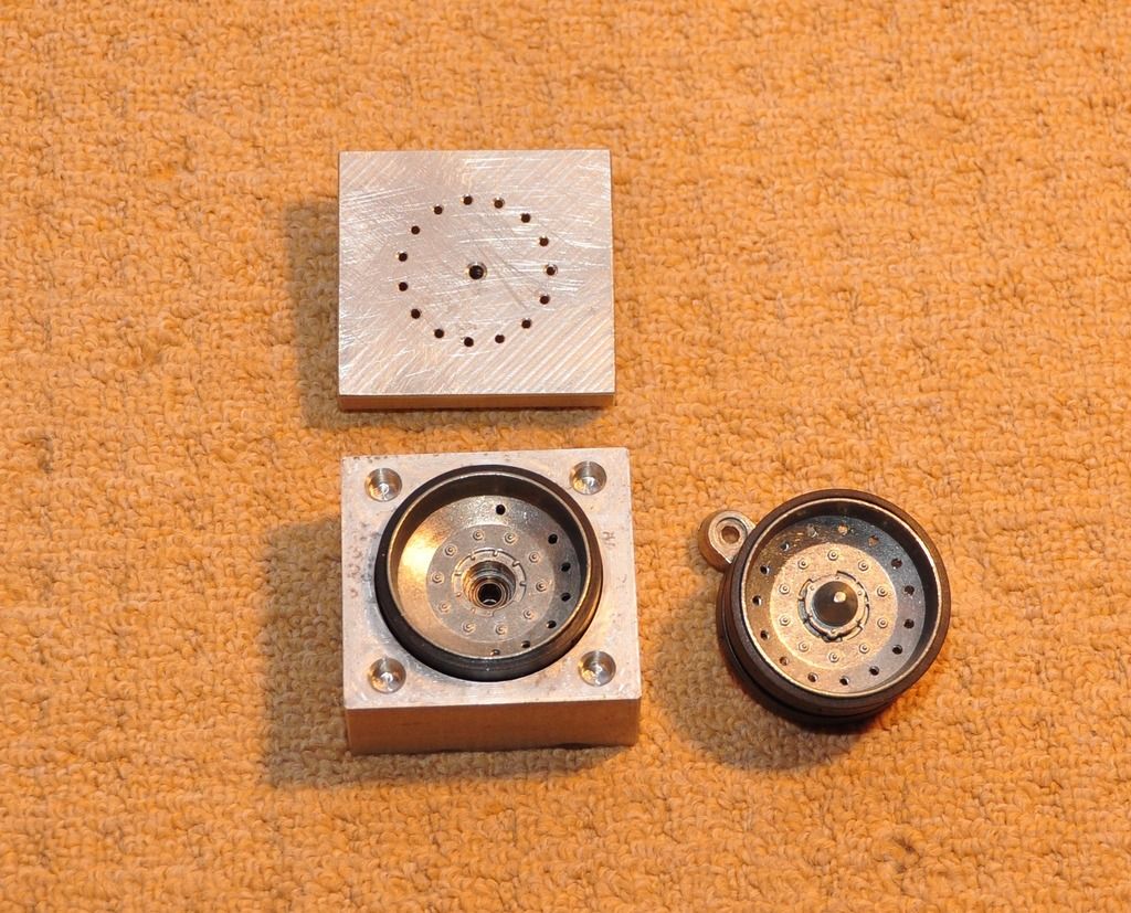

First off are the wheels..... this will be the newer type in which lightening holes are noted. In the real tank this helps clear out the build up of mud/debris on the wheels that will cause damage to it and the tracks. Carson did a great job on the jig. Its made of hard aluminium and its solid and very heavy just like steel. Drilling this using a hand drill proves to be fidly. You need to be very careful as the angle of the wheels itself will cause a slight angle deflection on the drill bit despite the jig. I have to stop working on this as I ran out of 2mm drill bits (I broke 3 already despite being careful. Also note that once you drill trough the outer wheel you have to pin it down with a 2mm broken drill bit on the first hole to maintain accurate alignment just to be on the safe side as it has a small "play" when you drill.Image
First of the 12 wheels........3 drill bits snapped so far. If you have a bench drill available it will greatly help as its more stable.Image

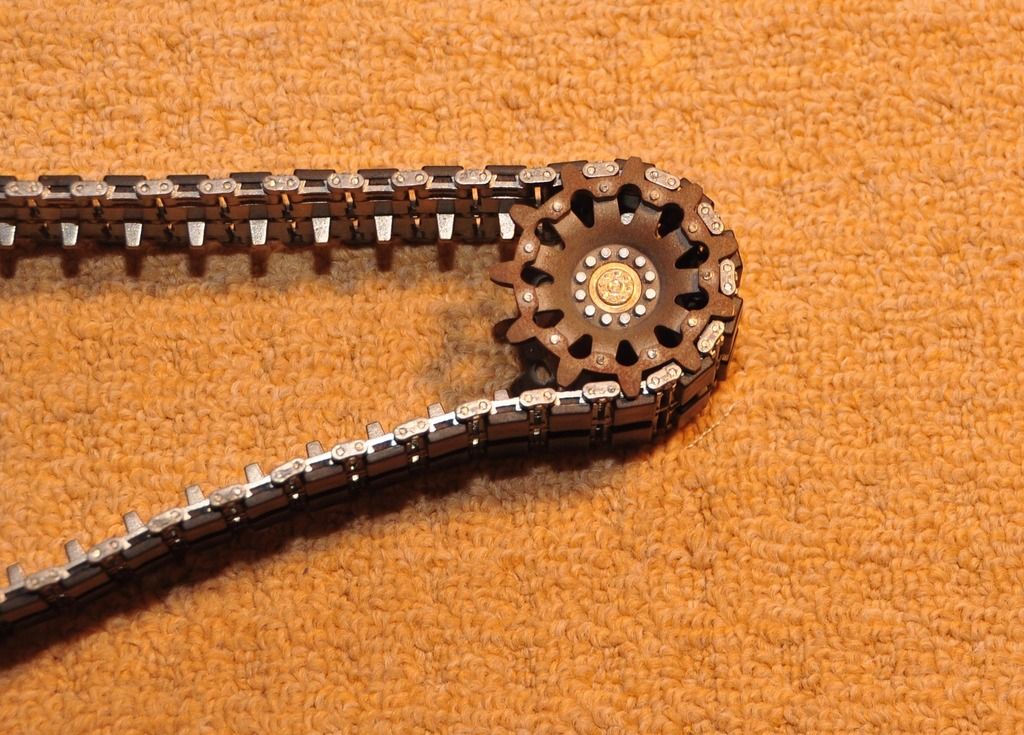

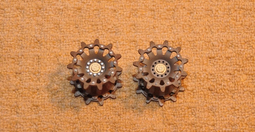

Next up are the drive sprocket. Before this was released by Carson I ordered it straight away and have to wait for a while as this is made to order. Full CNC (steel) specifically done to fit the Leopard 2 metal tracks. I know that the metal cast version had to be modified to be used with the Leopard 2 tracks and way cheaper and will serve same function and purpose. This is just my personal choice that I went with this. Having it in my hands, I have no regrets as this is a very precise piece of engineering work and the details are just amazing. The fit on the track is excellent.

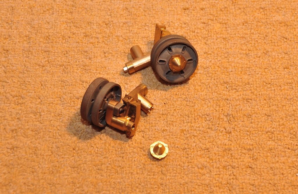

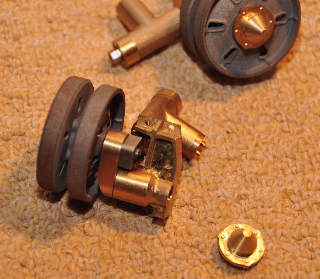

Then this....Again another superb piece of precision engineering. Carson outdone himself here. The quality is top notch. I have a full working track tensioner that can take the stress when you tighten the tracks. The only thing that will fail is the plastic chassis. Once Carson had the full metal chassis ready then I will upgrade to that as well.Image
