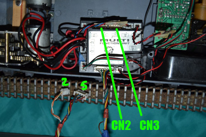

I have this stock HL Stug IR and not sure where these last two plugs go in? I have my other tanks set up with TBS
and forgot where this last 5 pin/ 2 pin plugs into the RX? Thanks Open ports are; left to right- CN2 and CN3
5 pin goes into CN2, the 2 pin gets jammed into the last two pins of CN3. If you are looking at the picture it would be the last two pins on the right end of CN3. Make sure the notch is facing in so one notch should catch with the CN3 base, and the other one just get jammed in there.
