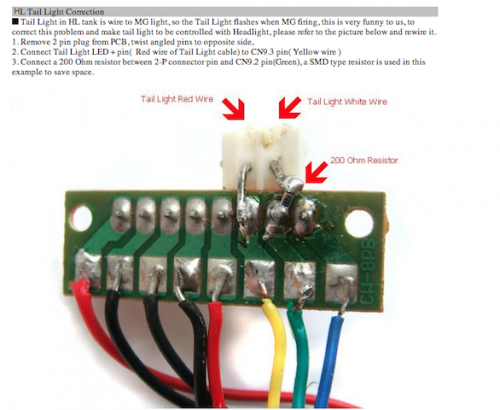

Hi Dude 2112,
not sure if this will fix your problem, but i did this and it worked. It stopped the tail lights flashing with the mg on my HL Sherman.
