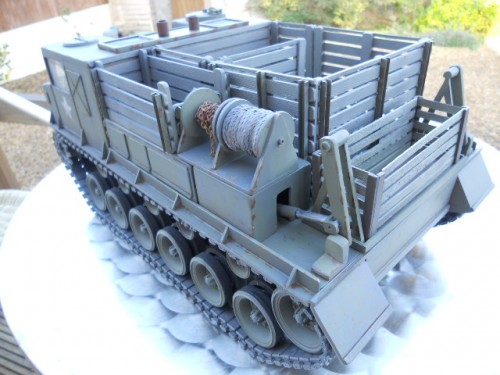

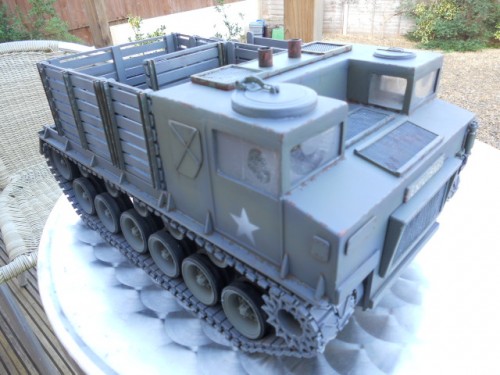

The one thing that has more effect on the finished result than anything else is the dilution of the paint, get that right and it's a breeze. The rest is just practicing techniques and how to get the effect that you want on the model. Compressors that don't have a tank like the cheapie ones will run down the pressure if the airbrush trigger is held down for more than a few seconds, so to maintain pressure just use short bursts of around 3 seconds. Invest in some airbrush cleaner as well, an internally spotless airbrush always gives better results.
Every once in a while disconnect the hose and leave it to dry out, as even with the water trap on the compressor some will still get out, and it collects in the hose.
And never forget the ability of a paintbrush, sponge etc, there are some thing that an airbrush simply cannot do as well!
https://www.everythingairbrush.com/airb ... brush.html
All spares are available, though I have only ever bought one new needle. It has a fully adjustable airflow on the brush body, so it can be adjusted for detailed work regardless of what the compressor is set at.
