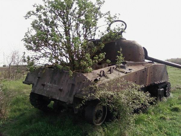

All full size tanks were originally factory fresh once.
(T34s at Stalingrad, for instance); but they were still pristine. I like my tanks pristine, and any weathering should come naturally..from use..as it did with the 'grown-up' versions (don't want to say 'real'..but) . That said, a spot of corrosion here and there, with credible oil streaks, exhaust staining, and other evidence of use all serve to enhance the appearance; as with adding jerry cans, netting, and so on. Some model tankers have access (lucky sods) to planned and developed battle scenes, with scale housing and scale infrastructure, or mini landscapes echoing the Ardennes, or, the mother-of all-battles: Kursk. There, I think it's appropriate to have 'abandoned' tank hulks, or those with serious battle damage; they can only add to serious wargaming. But if you want 'real' weathering you should model this:..I call it Sherman Oaks..(but not the L.A. district):
- Rusting Sherman hulk..real weathering
