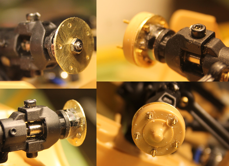

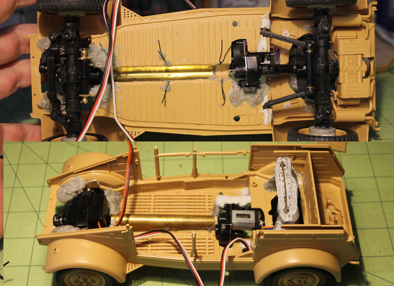

Best way to go about it is to measure the wheelbase and try to match an existing RC offering with your wants and needs in terms of price, etc.
I used Horizon Hobby's Losi Rockcrawlers for the Kubel and Schwimm, but taking a brand new $150 RC car and hacking it to bits might not sound reasonable to everyone. I went with those because I wanted a full suspension and replaceable parts. Horizon is well known for their parts and customer service and if I was investing the time into scale working lugs, etc, I wanted it to work.
But, really, wheel base is the key first. Second is if you want 4WD, third would be suspension. If you find something, make sure it's not a solid piece, that te drive train is separable. If you find something you like, you might be able to buy just the drive train in parts.

And I'd really appreciate your opinion. I also have a Kubel (just stock Tamiya RC) so I can compare to that as well. I would think the distance between the insides of the tires would be pretty important, so I'll compare the jeep with the kubel to see if I can use the same crawler you used on your kubel (or possibly the one from HK). The jeep is a lot heavier than a kubel and you know the kind of roads in my village from the videos and that's where I'll mainly drive it. I don't plan on taking on grass or loose sand.
