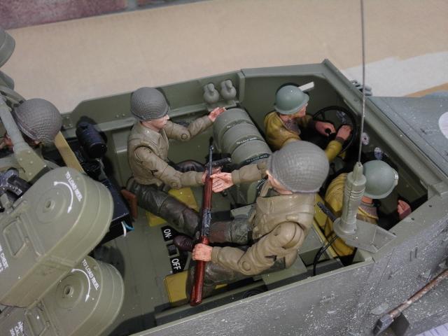

Not strictly a build, so if it's in the wrong place perhaps a nice, friendly mod would move it. Pretty much straight out of the box, it's just been made a bit dirty and dusty. Some fuse wire pretending to be cable on the front reel. Lastly, it's been crewed up, with the crew suitably armed, just waiting for trouble.

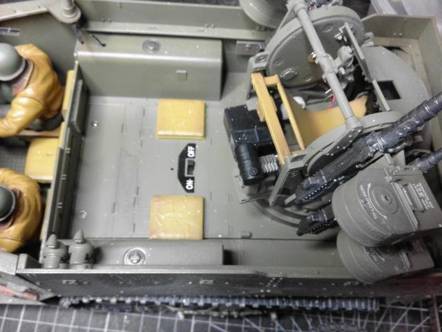

Got my idiot head on again this morning. I want to have a look at the electronics inside. Inspection reveals an awful lot of small screws, but, to me, no obvious ones to undo to open it up. The most likely candidates are two at the back of the gun compartment, but are there more? Is there anyone who has opened up one of these who can help, please?

If I remember correctly there's a couple of screws at each end of the cargo bed which allows the removal of the gun deck(two at the front are under the radio/ammo)..this gets you to the electrics...there's also screws that hold the back exposed...the cabs held with a screw underneath at the front and two behind the seats...

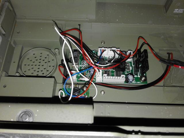

I've managed to clear some space and the new Elmod board has arrived, so I have made a start.
There is not a lot of room inside. Fortunately the Elmod is purpose built and fits using the same fixing points. I could do with some guidance though. The existing speaker is only 30mm diameter and very thin. Has anyone suggestions for a suitable replacement, please? I understand that the fitted one will not take the output from the board.

Unfortunately, the change over is going to take somewhat longer than I would have hoped and anticipated. On removing the Torro board, I discovered that the alternative power feed from a battery pack, rather than AA cells, was hard wired to the board. The plug and play Elmod does make any allowance for this, so I shall have to adjust the wiring for the power connections.
The second problem is that the receiver I was intending to fit simply won't. The pins for the channel connectors lie at right angle to the body of the receiver, and with the height required for the connectors, it is a non- starter. I have managed to find an alternative (I think) but have to wait for it to arrive to be certain.
Finally, I am still struggling to find a suitable speaker, so I will repeat my questions from above. What would be the minimum acceptable power output and can anyone recommend one that will fit in such a confined space, please?
