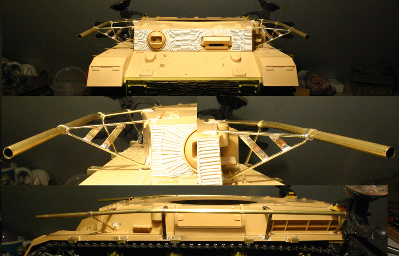

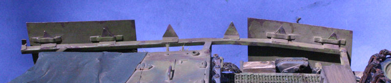

I use K & S engineering brass for everything for Schurzen to submarine prop shafts. I'm not sure if there is an equivalent over in the UK (or if there are stockists for K&S).
The trick is a hot iron and flux. If you pre-tin the areas you want to join, then clamp and hold the iron against it until you see both sides melt and start to bubble, you'll get a good join.
In terms of thickness, they make different angles and channel for the brackets and for the sheet, you want something thick enough to have some heft and hold shape, but thin enough to easily cut.
Here's mine on a Pz IV with Thoma schurzen and the StuG with solid.
