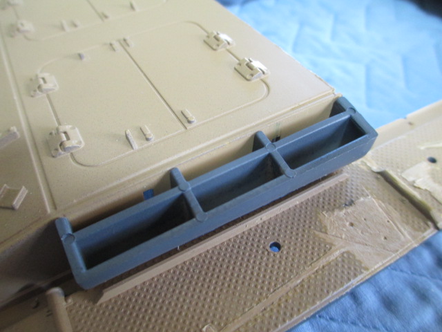

Can anyone point me to a build thread or instruction sheet for the photo etch screens for the Stug III? The intake screen on each side at the rear. Not sure which goes on top or if I should remove the plastic under the area where the screen will be. There are plastic braces under there that will cause a problem.

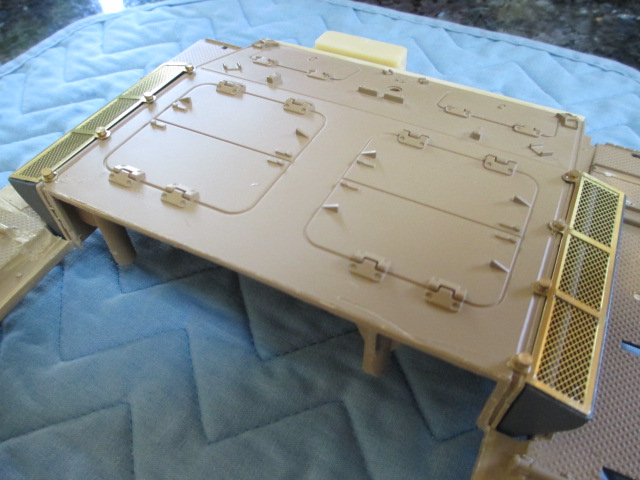

There are snap in replacements for those intake pieces made to use the mesh grills, I used them on the StuG Ausf. B. RCTank.DE has them in stock I believe.

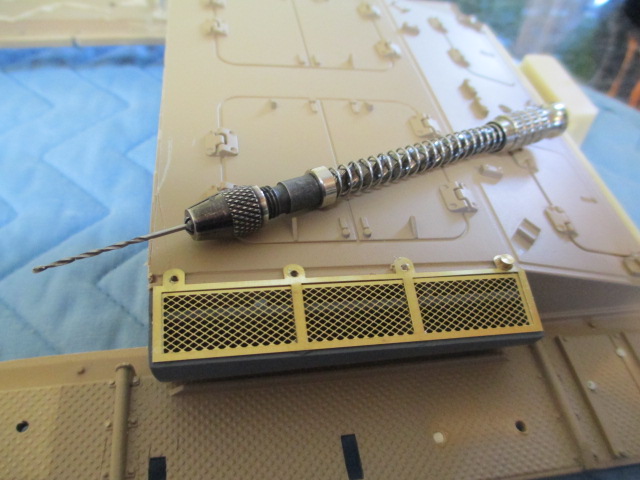

Using my Yankee Drill, holes are prepared for the bolts that add to the appearance and mounting of the PE brass screens and grills..JPG

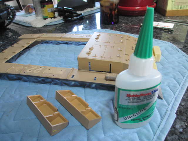

A couple of drops of 'Uncure' help make the removal of the stock HL airboxes a snap (no pun intended).JPG
