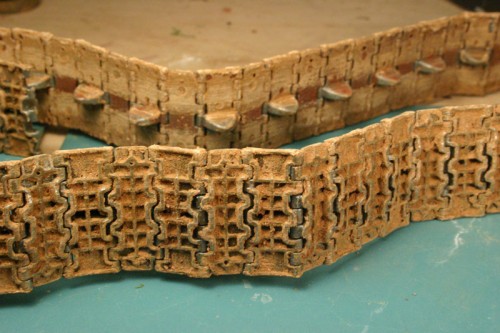

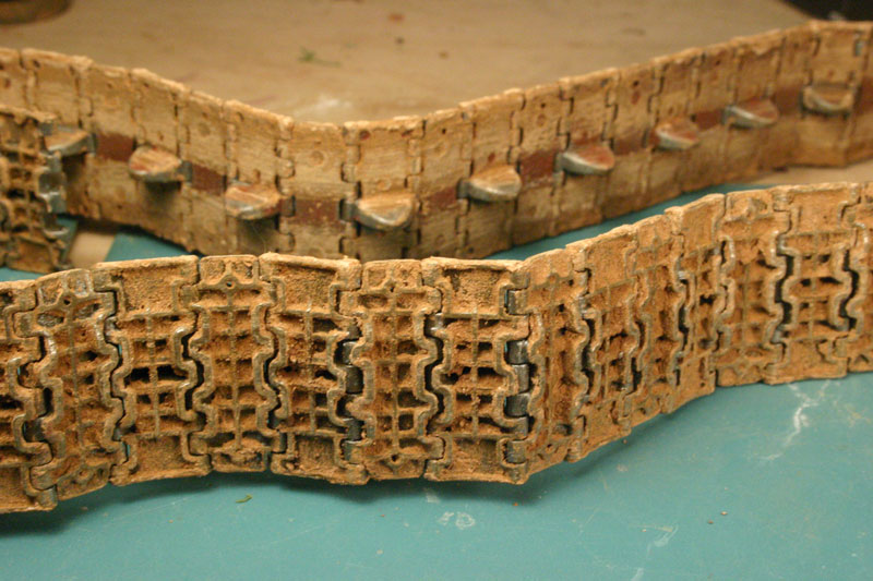

Here's a set of WSN tracks I am using on a Trumpeter/Tamiya conversion.
It's been battling for years now, including running on hard surfaces, dirt, stone and concrete.
It's base coated with Vallejo acrylic, then covered with dry pigments in an acryic binder. It's as rough as sandpaper and is not coming off.
Here they are in use:
What, me worry?
AlwynTurner
Posts: 2654
Re: Painting my UC plastic tracks???
Post by AlwynTurner »
That looks like the answer, I need to get hold of some pigment and give it a try. Many thanks Alwyn :thumbup:
