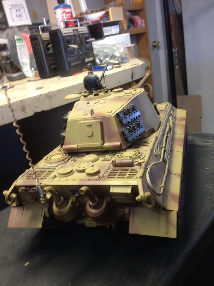

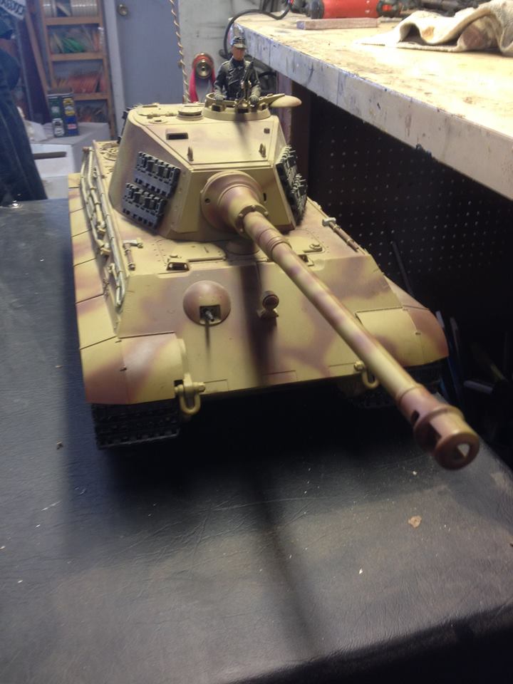

I picked this up today locally, from an ad on Craigslist. I had seen it listed for a few months, and really lowballed the guy. He took it. It needs some equipment to get it ready for battle. Barrel recoil and elevation, battle unit and some minor work. Price was pretty good at 200 USD. I will get on it after I am done with the M48.
There certainly are a lot of great Tamiya KT builds here to guide me. Since this does not have a battle system, would I be better off with aftermarket system, rather than Tamiya's?
Thanks,
Pale

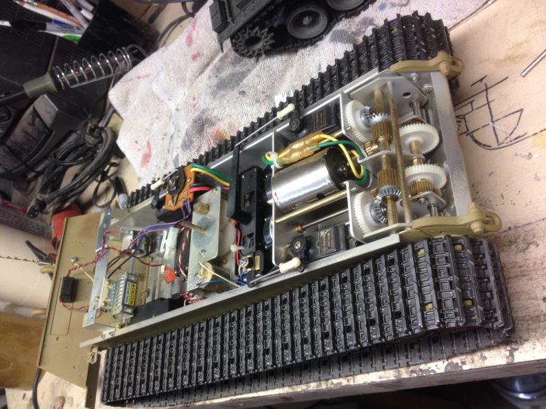

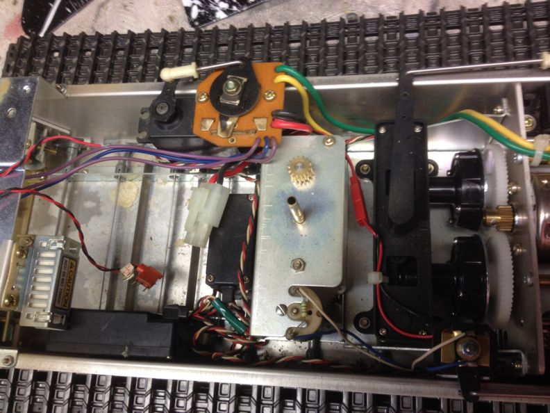

Here are a couple of shots of the internals. This one is around 20 years old according the seller. I appreciate all the input. Is this tank before the DMD system? If it is, am I better off going with after market or replacing with all the Tamiya stuff?
Thanks for all the advice,
Pale
Posts: 7875
Re: My first Tamiya
Pale,
For a 20 year old tank, that beauty looks to be in never run, like new shape. Even the motor has a shine still. I am not a Tamiya expert at all. If the tub matched with the newer stuff, you could replace the bits with newer and have a modern version. Seriously tho' , add electronics and at least run some of the shine off of those brand new looking gears and stuff to begin with. ;o)

PainlessWolf wrote:Pale,
Thanks Painless. Yes, it is in very good condition. I don't mind the clutch drive, but am wondering how that will play out with any sort of upgraded power board.
