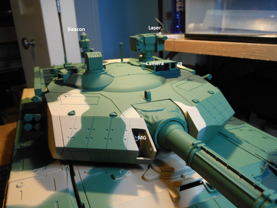

This is a very special ZTZ. It has my patented resin filled lower hull with magnet hold downs, steel gearboxes, 480 motors, metal tracks, sprockets, idlers, Clark board, servo recoil, TARR smoker with MegaSteam of course, A laser pointer for painting targets, coaxil LED machinegun that actually elevates with the main gun, and last but not least an FPV camera beside the IR emitter for my 7" LCD radio mounted viewer. The camera runs off it's own battery and I use a lipo to run everything else since there is a lot of draw with everything else running!
Taking it to our TET battleday and will do some action pics and video and show more detail on the FPV system. After this battleday she goes up for sale. More projects to finance in the works! :D
Not the greatest camera or photographer but here are some pics.

And the FPV for targeting! I was just talking to Erik this afternoon about trying a system like that. Do you think it raises the percentage of successful hits? What type of camera did you use? This is one of those tanks that's tempting to buy just to see what you used and how you did it!! :) Do you have a build thread? I hope! What TX are you using?

The camera and the transmitter is the FPV set from Walkera QR-X400 quad, DV04 camera and TX5803 5.8Ghz transmitter. Dean has it mated to a Boscam 7" screen. I have couple of screens as well and also the DevoF4 with the Built-in LCD on the radio. In theory it will work with most of the 5.8Ghz FPV set-up. The laser is your run of the mill laser pointer powered thru the AUX power on the Clark board. The location of the laser is in the actual laser counter measure housing. The targeting system housing actually has the camera and the IR emitter.
