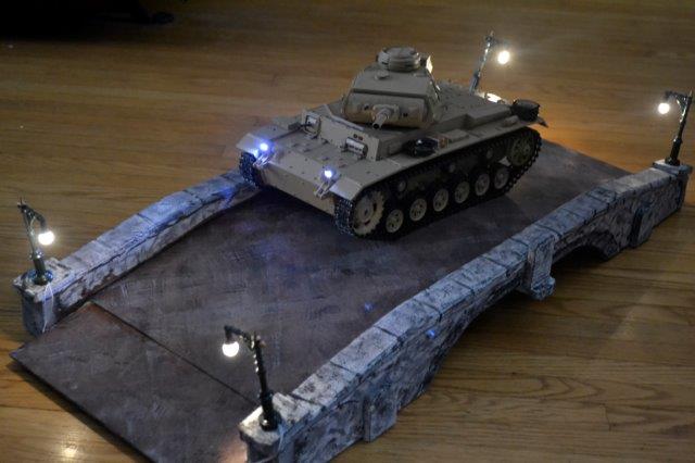

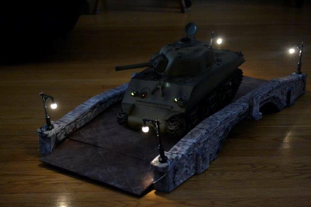

Build a Bridge for my tanks, heres 2 of them trying to cross.

Nice bridge firefly, like the light poles. What is it made of?

Hey Greengiant,
The Bridge sides are made from dimensional lumber, 2x4 spruce cut lengthwise and band sawed the arches. the road is 1/4" thick birch ply. Glued to wood struts attached to the bridge spans. Painted with acrylic paint, base coat of black then sides builtup with off white, grey and black lines for detail. road same base with grey and burnt umber /red streaks. The street lamps are from the dollar store Christmas village collection and the battery compartments hot glued under the roadway. I'll post more pics of the underbelly and layout. any more info let me know, had fun building it in my shop took longer to paint then to build from scrap lumber.
