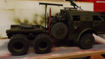

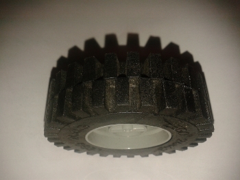

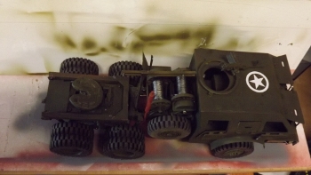

Hi you need three things a Tamiya Chassis 6x4 ,lego wheels , and plastic card. Then you could end up with this .If you have a bruder low loader you can use that for trailer .
regards pete
regards pete

That's a nice Dragon Wagon! I've been poking around looking for parts, and these things can easily beat tanks out as a money pit! lol
The search goes on!
The search goes on!
