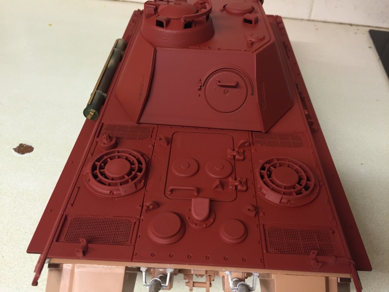

I fitted the new fan housing and antenna mount this evening and then added the final detail pieces to the rear deck plates.
I got the parts from a damaged HL Panther top deck that i got from Forgebear.
Some careful cutting with Mr Dremmel to cut out the section and then trimmed. I then had to do a bit of a final sand to get them flush. I guess only 30 mins or so.

I completed the major work on the turret & top deck so added some casting effect with my home made Mr. Surfacer and then gave them a primer coat of Halfords red Oxide to see if the finish was ok.
I am pretty pleased how the mantlet turned out & any imperfections will be covered up when the zimmerit added.
The new fan housing and rear deck area looks pretty good and now ive added the panel lines and bracing to the rear deck it is nearly complete. Just a few beads of welding to complete.

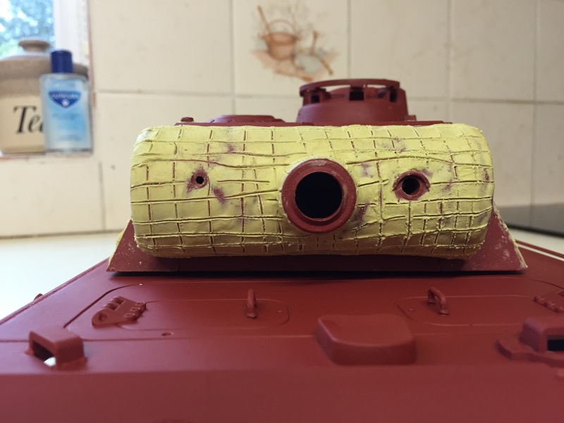

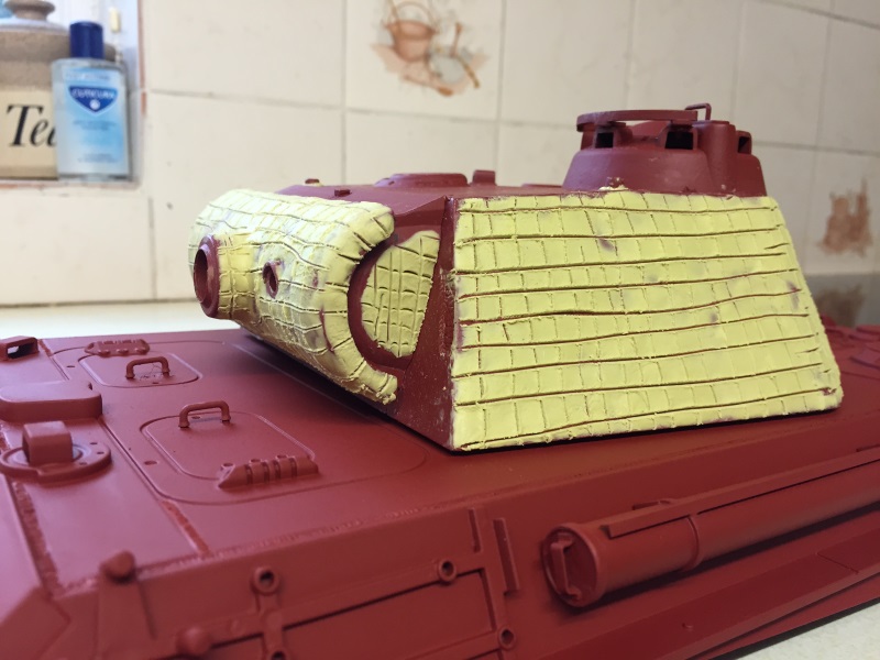

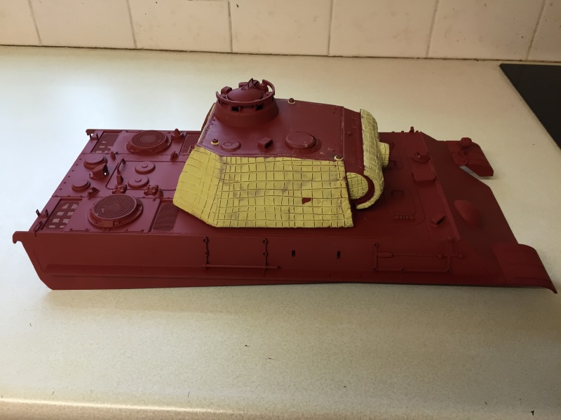

Ive fitted the etched fan grills and added all required weld lines to upper hull & turret.
Ive just completed adding the Zimmerit coating to mantlet and turret using standard Milliput.
This is the first time ive tried to do zimm on a 1/16 tank and i found it to straightforward once id worked out the technique.
I just mixed up a ball of Miliput and smeared a small amount onto the model, then using a wet finger or thumb, spread it out evenly over the area until a thin and uniform layer had been added.
I applied to one panel at a time, using plenty of clean water to keep it wet and smoothed out.
The panel was then patted dry with a paper towel which also slightly roughens the surface.
I then used a tool to 'scribe' the lines in on each panel trying to get it not too uniform and neat as was done on my Armortek.
Anyway, hope you like the results so far.
