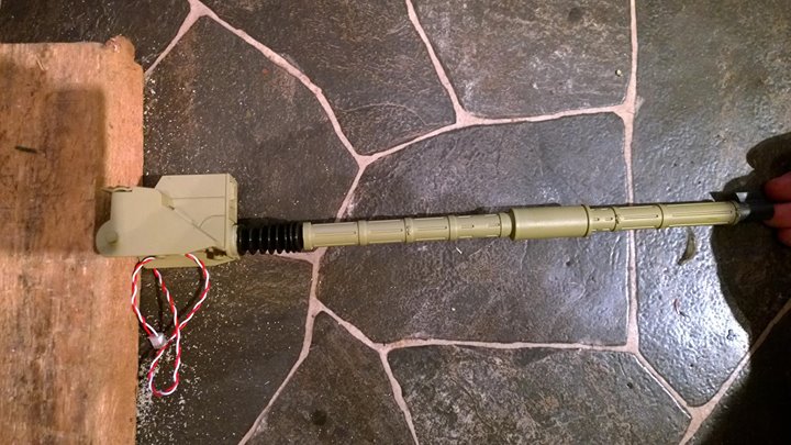

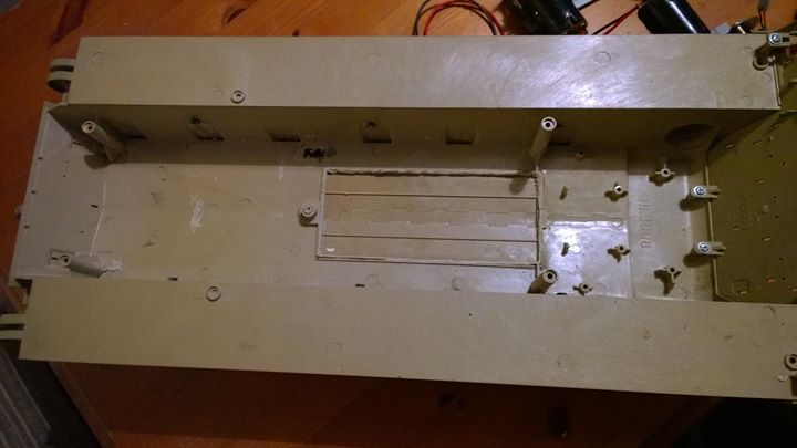

So I have added the metal gearboxes and stripped-down inner hull, now serve recoil here it is do far
Hull stripped-down

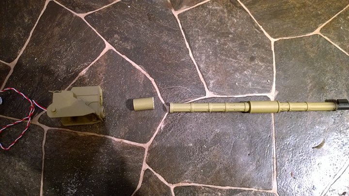

Barrel cut before and after gaiter
Motorcycle clutch cable gaiter used

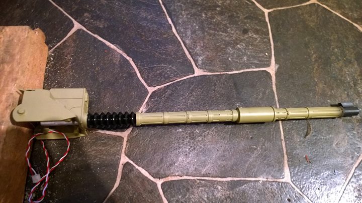

And here it is in the rough extended position
Not sure about this gaiter have a few others in the way to try. Next just got to extend the bb barrel and connect to servo, update in next few days as am on the piss later! Enjoy!

Hey scalawag, yeah its just in that position while I wait for the glue in the barrel extension to dry, once it is it will be more bunched up than that

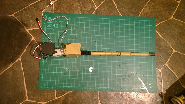

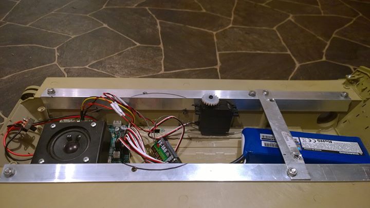

Servo traverse and recoil completed today just servo elevation to go! And hull bracing added after removal of battery box, here's the pics!
