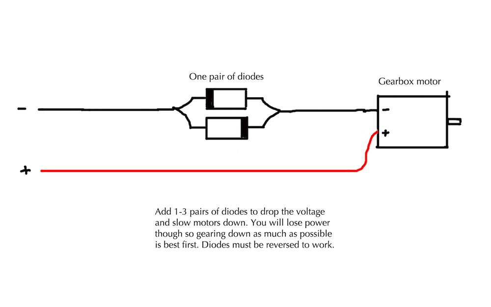

Can you take a look at my gearboxes above, are they 3:1 gearboxes? Changing gearboxes doesn't sound so good to me because I've just change these gearboxes and they are ordered from China. It's a long way! Connecting diodes sound nice because I can source them locally and do it myself. However, can you be more specific on how to connect. a diagram and a photo would be appreciated.

Run them end to end in pairs on a power lead for each motor. Though by dropping voltage you will lose some power
so ideally gearing down as low as you can first is best. 3A 100v Diode Rectifier

tao, the above instruction regarding diodes reducing speed is about giving it less power so that it goes slower which means the tank lose power. it might not be able to crawl up slop if you do so. I think the right way reduce speed is using high ratio gearboxes. It might cost me another 50 bucks doing so.

Yes as I mentioned best way to start is gear reduction/ 4 shaft gear box. Then I added a few diodes and it still can pivot turn on carpet and crawl very slow. But max power will be reduced a bit yes.
