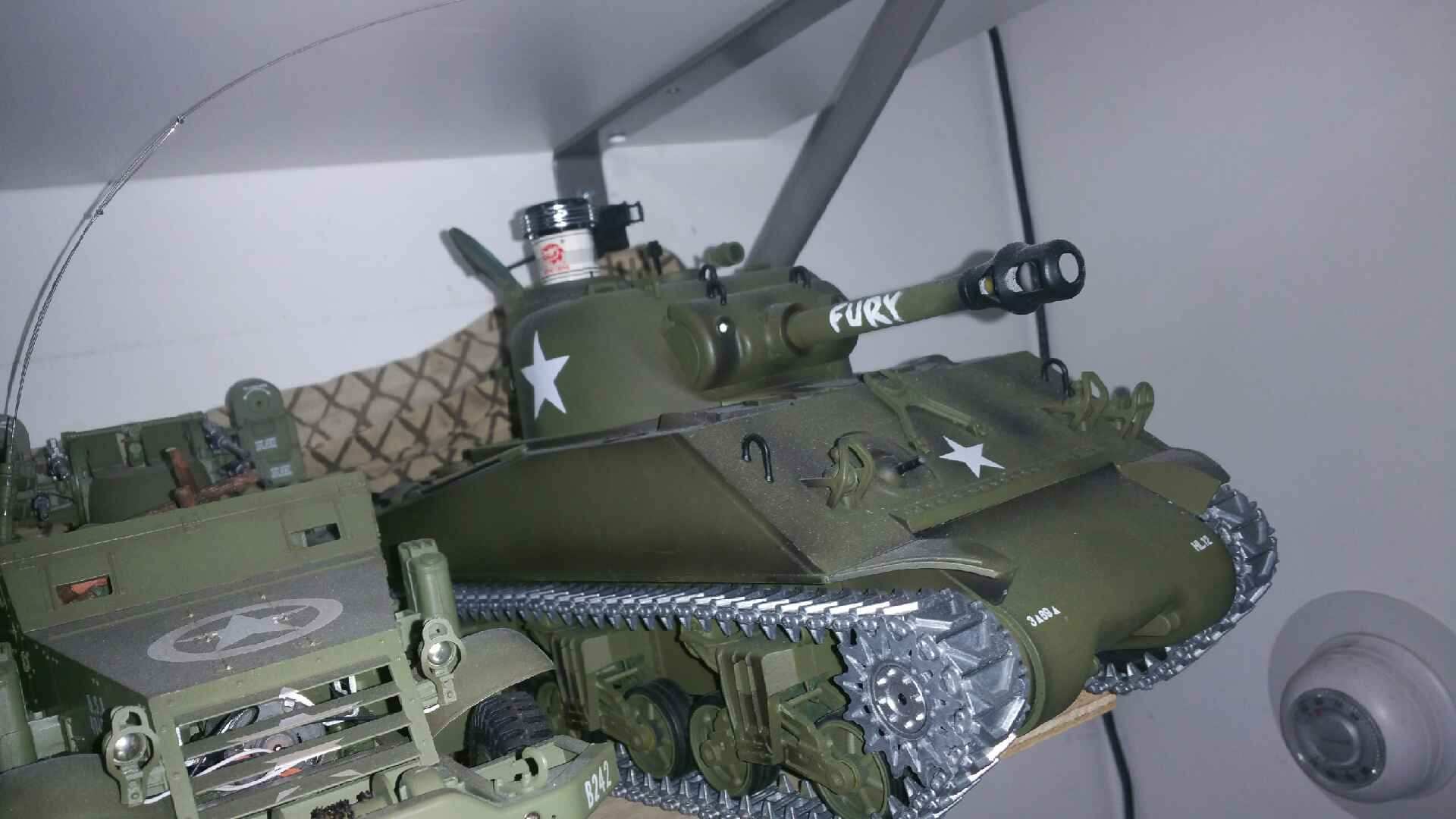

scottd1975
Posts: 41
Joined: Mon Nov 16, 2015 6:32 pm
Re: Found a deal maybe please help me figure it out
Post by scottd1975 »
Here is the tank
tomhugill
Posts: 4880
Post by tomhugill »
Looks like some ones bodged a panther barrel on a standard henglong. Avoid avoid avoid.
MichaelC
Posts: 2449
Location: Toronto, Canada
Post by MichaelC »
Well the only thing "fury" about that is the name on the barrel, and it looks like he needed a big barrel to get it on there.
Metal tracks would probably make this thing new for about $180 USD. Otherwise the only fury you are going to get is your own after you get this sucker.
jtracks
Posts: 1209
Location: Roseville, CA.
Post by jtracks »
scottd1975 wrote:Here is the tank
Hi Scott, that looks like a Heng Long Sherman to me. It also looks like the 105MM cannon that someone has added a muzzle break to. The tracks appear to be Heng Long as well. That doesn't look like a Tamiya Apple=Tamiya Battle Unit to me either but I may be wrong. So, it may have the upgraded RX-18 vrs the RX-14.If it doesn't have a Clark, IBU2, BARC, or El Mod electronics board you will only be able to battle with other Heng Long tanks. In stock configuration, Taigen, Heng Long, and Tamiya are not compatible electronics when it comes to battling.
