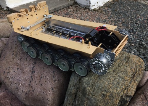

Tools scattered everywhere; discarded wires, vital bits of tank cast aside: all evidence of frantic activity, and a house that looks like it's been burgled. But, it's just an old manic Highlander shouting his way through the process of fitting a Clark Tk-22 to his early production Tiger 1 project. (No turret number as yet..but 666 comes to mind..yeah, I know, there never was one). Having already finished the exterior, the Tiger needed a heart transplant to give it character. The plodding 2.4Ghz stock Taigen system I'd built it with, though fairly dependable, was always uninspiring, and had to go.
But this old dinosaur, from the age of cars with starting handles, TVs with 9inch screens (came with large magifying glass to boost the screen size..true that), and steam trains, had never looked at tank MFU systems before, let alone handled a programmable Rx/Tx. (Spektrum
DX6i with AR610). This was always going to be a recipe for bellows of frustration across the Loch. In the event, and in the modern spirit of self- congratulation (why DO people applaud themselves on Tv?) I'm going to give myself a wee pat on the back. The Clark transplant is beating away, and the tank is a different beast..and the Spektrum (really could do with centering left stick) handles quite well....but there's a thick manual to go through., and much help needed.I've benefitted from the pain and gain demonstrated in the forum archive, of all those prior frustrations. I've also built PCs, and worked with (home) recording studio electronics/ hi-fi etc., (Guitars and amps too), for many decades...but this RC stuff is from an alternate universe. Now about the Clark:

So here's the final product (for the moment), the 666:-
Step 1, Taigen chassis, with taigen metal running gear just added..
