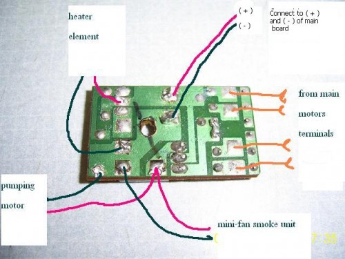

I saw that Heng Long have a proportional board for their smoke unit and that may work but the question is if it got the battery voltage in and then regulates it for idle and running getting signals from the reciver? Then I could use this board and start it by a reciver controlled switch at startup.. Anyone knows the full function of the board?
If a someone have a Heng long proportional smoke unit it would be soo kind if you could measure if the input voltage (where the wires go from the Main board into the smoke unit board) is constant into the board when running?? Then it uses the voltage from the motors when running and voltage from the board at idle!!

I order a HL prop. board, im almost 100% sure that it got a "standby voltage at idle from the mainboard and gets power from the motors when the tank is running, why need the motorwires otherwise? I will try it with some other electronics before plugging into the Tank motors. If it dosnt work i go with the diodes solution!
The smoke will start by a transmitter controlled switch, so I could "preheat" the smoker before i give signal to the Main board to start so smoke cames out when the tank starts!
I get back when i have tried it, it could be a great solution for all the MF-01 board users who wants proportional smoke!
