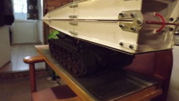

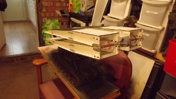

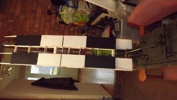

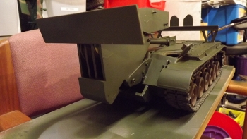

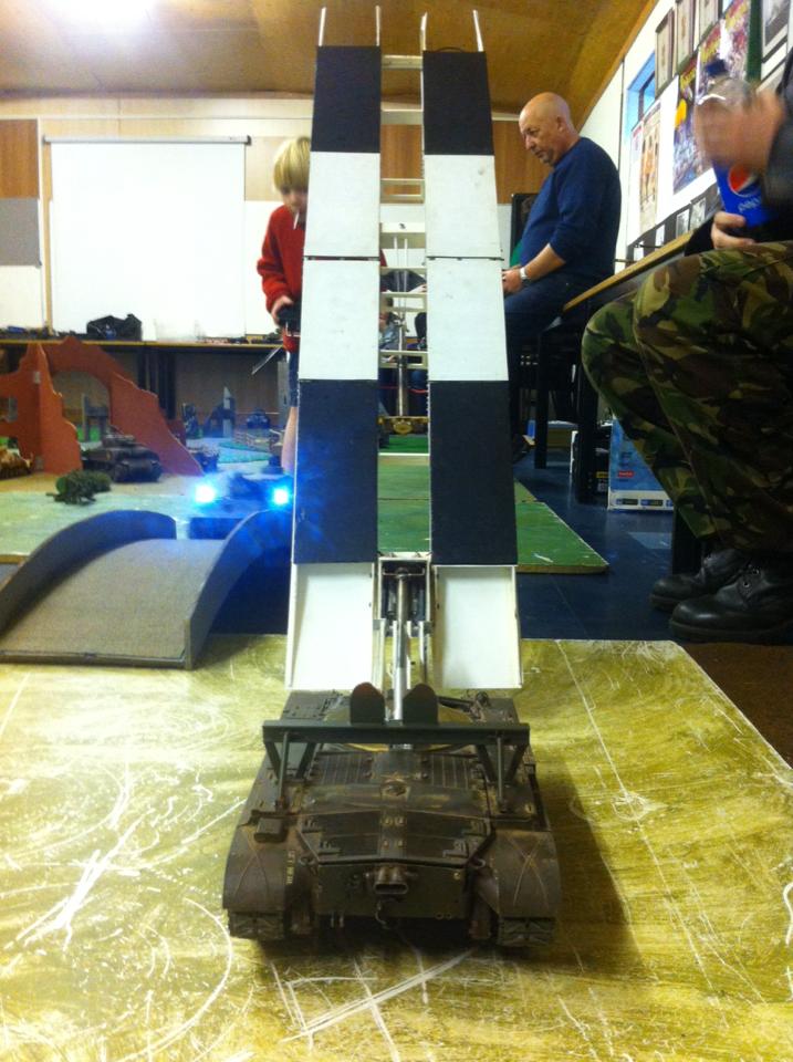

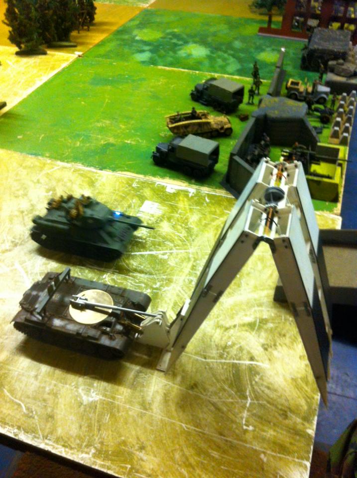

Hi Guys have spent months getting to this point, Have a working bridge layer still have a load of work to do , but finally got it to work , needs a few mods to it but the basics work . Please note that rivet counters there is no point you looking because its miles off. Had to change loads to get it to work , but tried to stay within my tolerance's if it looks right it is right LOL. Need to do a load of work to hide the workings and make it look more like a M48 . Not changing the hull from the Pershing (because if Chris 3 can make a solid Centurion lower will change over to that hull) If this happens can change the pershing to a another model. The Israel's had the M48 bridge layer fitted to the Centurion so did other armies . here are a couple of photos and a video http://youtu.be/tf8vMpUkSZ0
regards pete

I know how long and hard you have worked on this one Pete, and the problems that you had to overcome. You finally did it, and it looks really good, all working nicely too. Well done, perseverance pays off! :thumbup:

Absolutely SUPERB.....

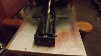

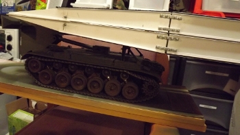

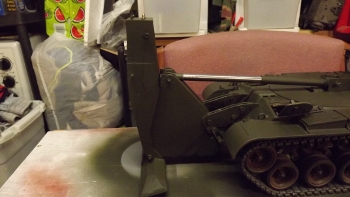

Post by 971wright »

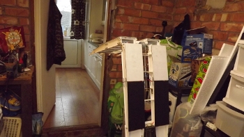

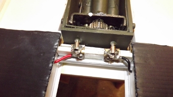

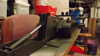

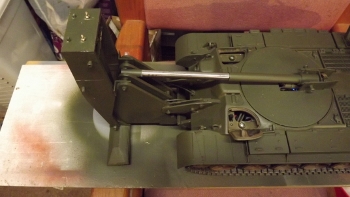

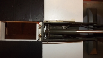

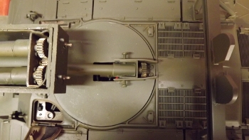

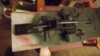

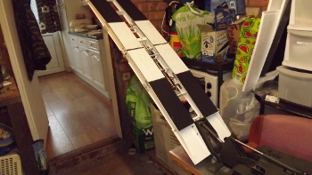

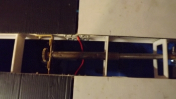

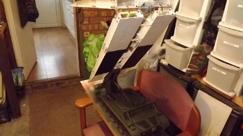

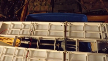

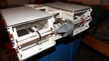

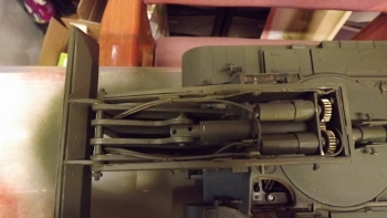

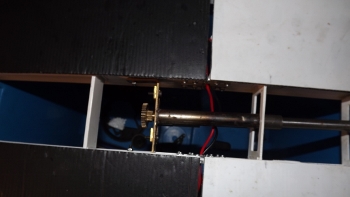

Hi Some photos of how it is put together .
more to follow
regards pete
DSCF1161 (350x197).jpg (143.47 KiB) Viewed 6362 times
DSCF1160 (350x197).jpg (134.86 KiB) Viewed 6362 times
DSCF1159 (350x197).jpg (159.39 KiB) Viewed 6362 times
DSCF1158 (350x197).jpg (149.03 KiB) Viewed 6362 times
DSCF1157 (197x350).jpg (150.18 KiB) Viewed 6362 times
DSCF1156 (350x197).jpg (150.52 KiB) Viewed 6362 times
DSCF1155 (350x197).jpg (145.35 KiB) Viewed 6362 times
DSCF1154 (350x197).jpg (153.73 KiB) Viewed 6362 times
DSCF1153 (350x197).jpg (153.14 KiB) Viewed 6362 times
DSCF1152 (350x197).jpg (147.32 KiB) Viewed 6362 times

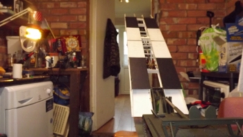

971wright
Posts: 2733
Location: nelson Lancashire
Re: working bridge Layer
Post by 971wright »
More photos
regards pete
DSCF1173 (197x350).jpg (152.08 KiB) Viewed 6359 times
DSCF1172 (350x197).jpg (164.72 KiB) Viewed 6359 times
DSCF1171 (350x197).jpg (161.31 KiB) Viewed 6359 times
DSCF1170 (350x197).jpg (137.25 KiB) Viewed 6359 times
DSCF1167 (350x197).jpg (113.6 KiB) Viewed 6359 times
DSCF1166 (350x197).jpg (119.53 KiB) Viewed 6359 times
DSCF1165 (350x197).jpg (150.3 KiB) Viewed 6359 times
DSCF1164 (350x197).jpg (154.85 KiB) Viewed 6359 times
DSCF1163 (350x197).jpg (114.28 KiB) Viewed 6359 times
DSCF1162 (350x197).jpg (120.07 KiB) Viewed 6359 times

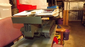

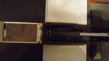

971wright
Posts: 2733
Post by 971wright »
Final lot of photos
regards pete
DSCF1181 (197x350).jpg (134.91 KiB) Viewed 6358 times
DSCF1180 (350x197).jpg (154.38 KiB) Viewed 6358 times
DSCF1179 (350x197).jpg (136.37 KiB) Viewed 6358 times
DSCF1178 (350x197).jpg (160.99 KiB) Viewed 6358 times
DSCF1176 (350x197).jpg (161.22 KiB) Viewed 6358 times
DSCF1175 (350x197).jpg (167.97 KiB) Viewed 6358 times
DSCF1174 (350x197).jpg (158.43 KiB) Viewed 6358 times
