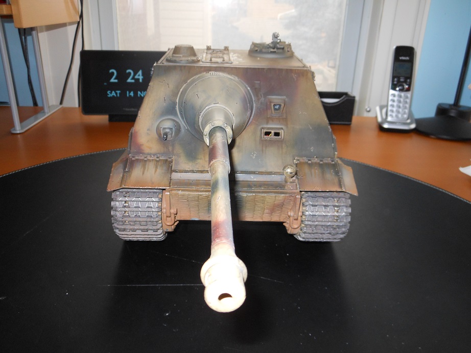

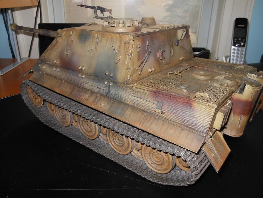

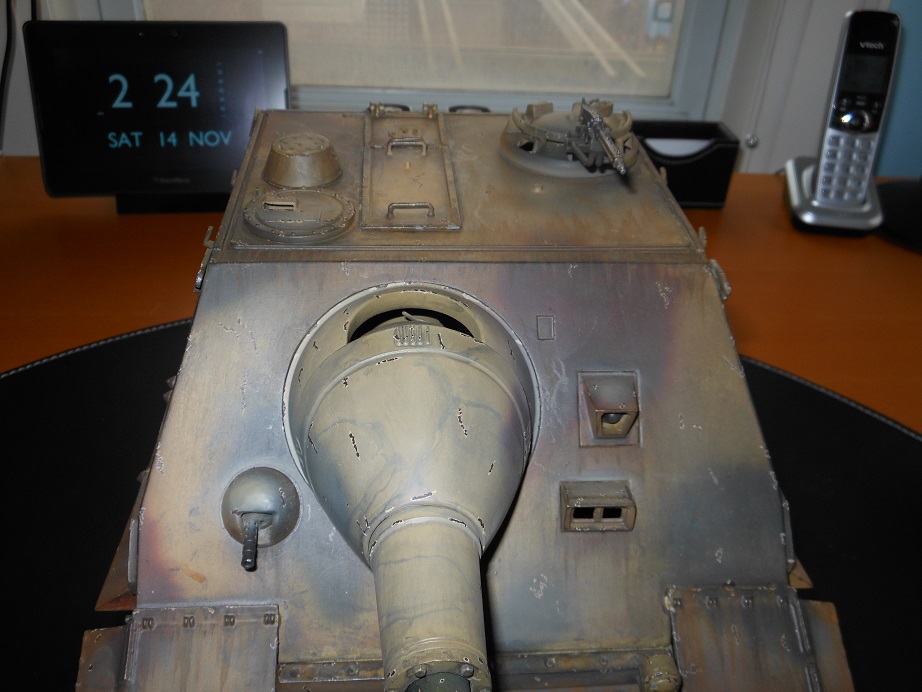

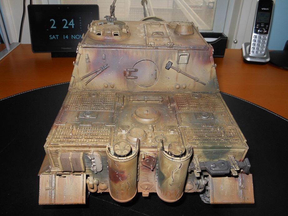

Not quite a build thread. It has also been properly weathered by dgsselkirk so I can post some pictures as well. I also find these pictures online:
viewtopic.php?f=33&t=13526&p=121835&hil ... um#p121835

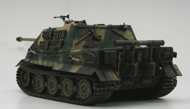

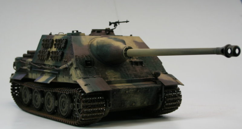

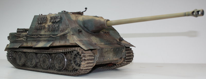

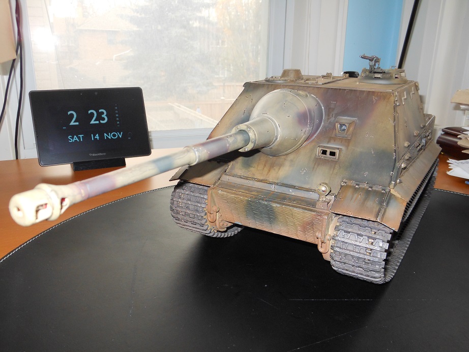

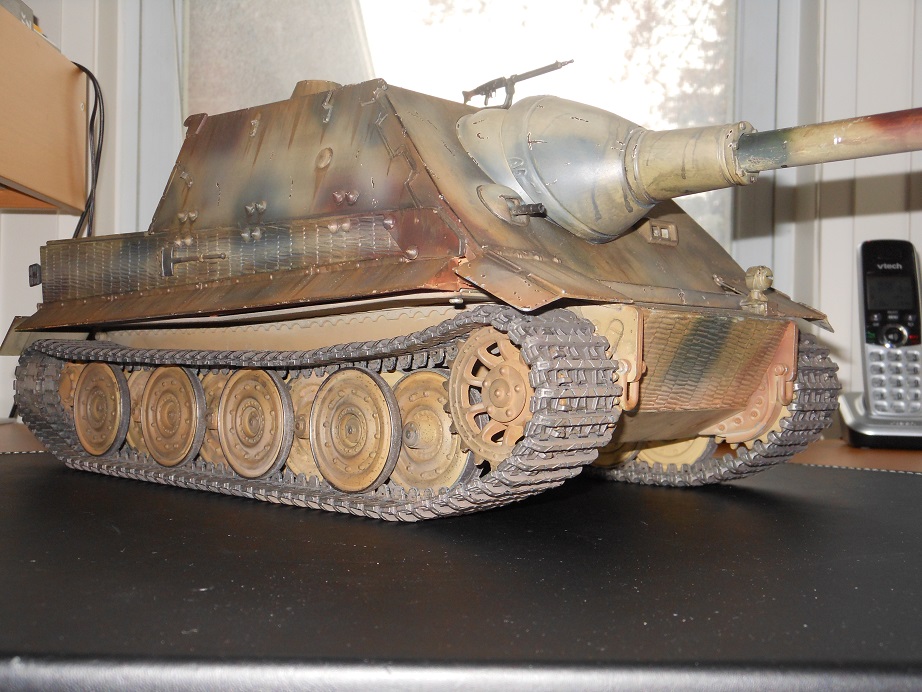

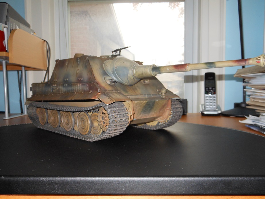

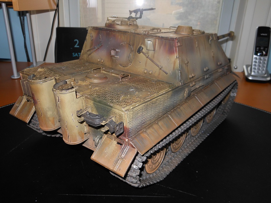

Here is my version of the JadgStrumTiger. Taigen Late Tiger metal chassis, Asiatam all metal upper with the JadgStrumTiger roof plate and pig nose mantlet and the 88mm L51.
Notice that the prototype doesn't even have the balance ring on the front of the barrel.
