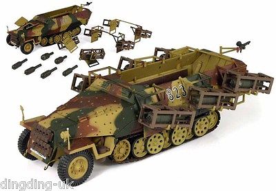

Hi all,,been away sometime,, just got the sdkfz251 from 21century, it's a static version, now what I'm inquiring about is what I will need to convert to RC,,the actual receiver bord I have torro, which I can fit nicely, just what motor, steering gear, drive connection to tracks, infact what parts I will need an wer to get them if someone can help much appreciated,,,

I also have one of these. I've been thinking of using the running gear from a RC 1/35 tank but haven't got to far at the moment. so looking to follow this post with intrest

I was think to use standard motor heng long,, but it's figuring the drive link that's the head spinner,, because of the space under the bonnet,, or hood to our American friends,,, I got lights fitted and work well, servo for steering gear is sort of there I figure Im going to have to fabricate linkage for it I'm using my M16,, as a guide,, but I definitely need some help on the main drive,,,

I have it from a reliable source that Chris\Ludwig is going to be coming out with linkage stuff that will work on these 1/18 halftracks. Both Jackalope and I are doing one as well.

I picked up one from by buddy MichaelC. He used VS 1/12th scale motors and installed a Clark board and let the front wheels "float" free. It works really well as the it drives like a tank and the front wheels just follow the direction turining. Gives great sound and it can then IR battle too. I am planning on mounting a Pak 40 with recoil and elevation and making it a little fighter!

Its Vs 1/24 scale motors that you can get from them @ $20 USD shipping included. Here is a link the original thread where I got my idea from a fellow local tanker and he even use a servo as steering linkage:

Thanks all for the info will investigate, I'm trying to keep it simple at moment just to get it moving then get more ambitious,,

ray, if that's the case you should just replace the drive sprockets with the Vs tank gearbox as it is basically a drop in after you take the body apart. Leave the front end as is since if you put in tank electronics it will drive the tracks to make turns so you don't need the front steering at all and can just leave it. I can try to find a video of the one I sold to dgsselkirk and you can see how it would run like that.

Hi all back after a long brake,, well the 251,is coming along electronics and drive motors,And my smoke unit, plus drive train, plus sound,all working just installing front steering at moment so almost finished, I tested it fully for 2 hours continues running with no problems at all
