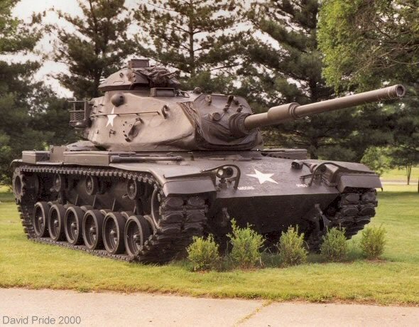

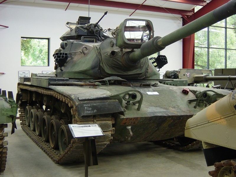

Hey Guys, It has been a while since I have any thing to offer around here, but I have been lurking the entire time of my break. :) So now the snow is flying here in the Rockies, and am looking to pickup a build this winter. I have always considered building a M48 or M60A1 Patton. I see that Century makes a 1/18t scale static. Sure, I could go through it and motorize it. Or, I could get a Pershing chassis and have it with some fab work and some casting. Perhaps Santa could bring me a 3d printer this year. ;D I have been good.
Anyways, if I am going to build another one this winter, I want to step my game up a bit. That being said, adding power to the Century version would probably about as big of challenge converting one out of the Henglong Pershing. Thoughts?
I appreciate any input. Thanks in advance.
