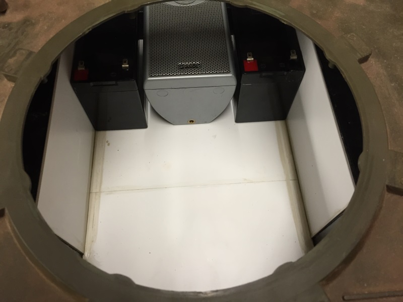

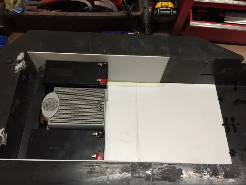

Hi all, here is another quick post with a few pix.
All of the original internal bulkheads are now cut out and in the bin.
I have glued in the new plasticard floor (2 x 2mm) on top of the original floor that was cleaned up and levelled.
The floor is now very rigid.
I have just glued in the 2mm side panels for the rear half of the hull. The front half will be done tomorrow night.
I've already used 4 sheets of 2mm plasticard!
This really is just a big Heng Long. I've done this to the lower hulls of everyone of my HL tanks so far.
I just hope that i can get the balance of the tank right with all this weight at the back.
I may need to add some ballast up front.
More updates soon.
Tim

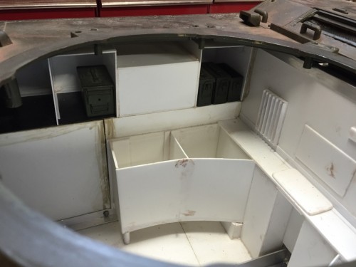

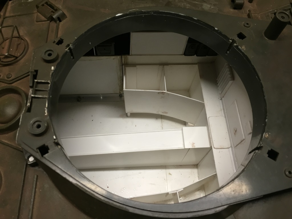

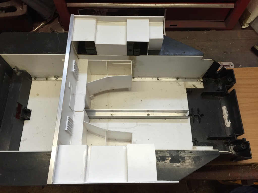

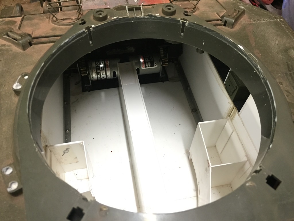

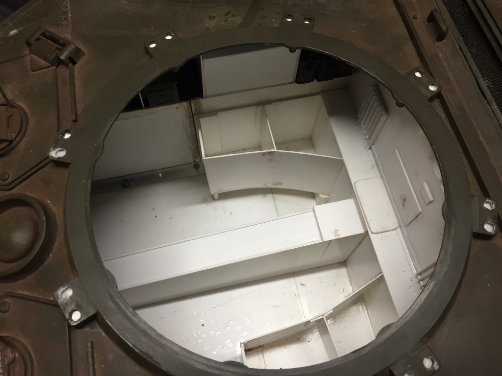

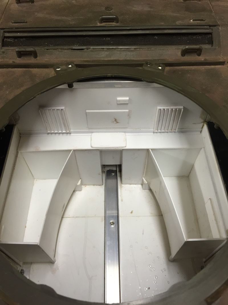

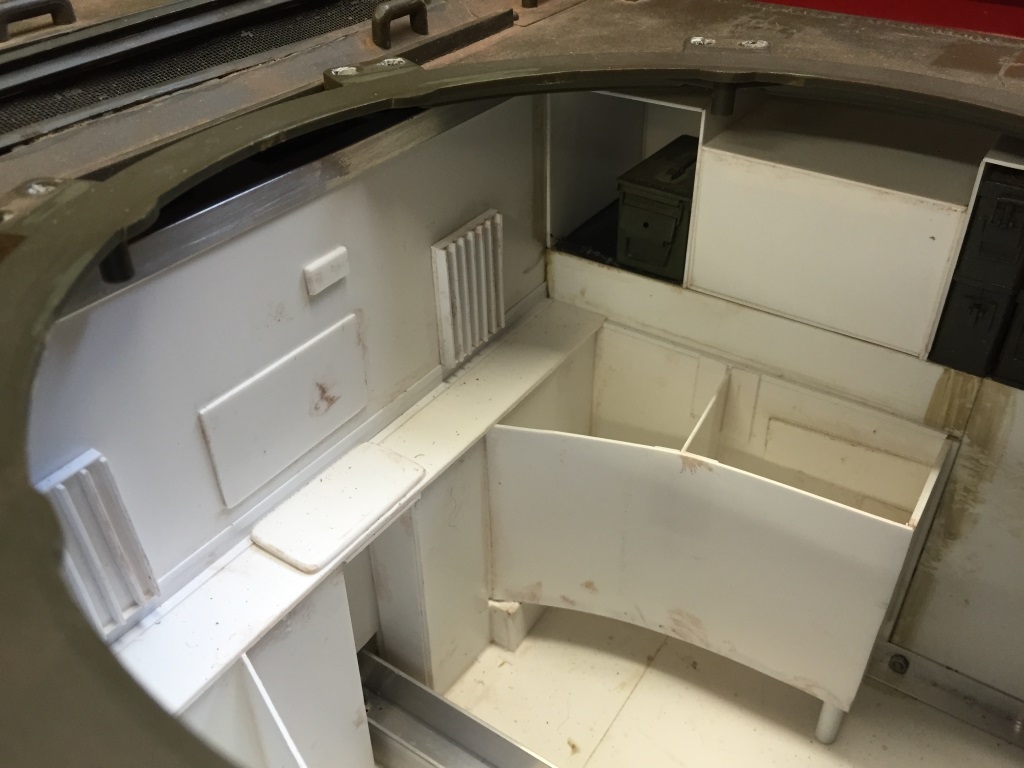

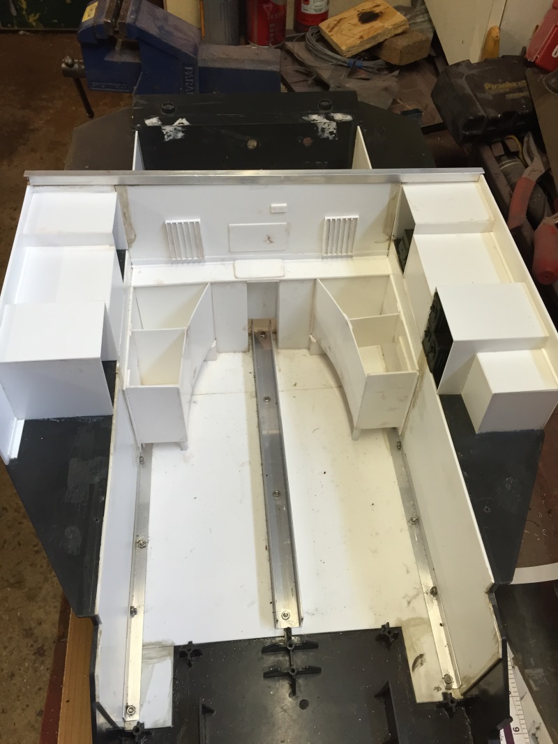

Hi all, i completed the basic construction of the storage bins on each side Sponson last night. I Still have to add clasps and hinges but am pleased with how it is looking so far.
I am planning on making the cover to the transmission tunnel tonight, but now sure as yet how i am going to secure this.
I am wanting to run cables through this tunnel, so may need to remove it from time to time.
One issue is that once ive opened up the turret i will lose the current method of traverse so im looking at alternatives. Also, after the added detail in the fighting compartment, i am now struggling to think how to get the traverse working from the turret ring.
I am now thinking of adding a turret basket as per the original and then add the gear ring to the base of the turret basket wirh the drive motor attached to the floor out of sight and underneath the basket. Not sure if it will work but will try a Heng Long setup initially as i have all the spare bits already.
I did a dry fit of the motors & batteries and all other electrics last night and all can be tucked out of sight , BUT, i am concerned that there will be a lot of weight at the back of the tank in the engine bay with 2x 7a batteries, smoker, 40w amp & Benedini, speaker plus the 2 Electronize speed controllers.
I will have to re-visit this soon before i get much nearer to completion.
Tim

Cheers for that Pete. Iam also looking to see if i can adapt the original traverse unit to work somehow.
Anyway, i actually cut the base out of the turret this evening, so no going back now.
This first shot has the lower half of the turret in place so you get an idea of the fighting compartment. I think ive got aprox 12cms below the base of the turret for the turret basket which should be enough room. I should be able to to fit a 4" or 5" dia gear ring to the base and hopefully drive the traverse.
The final shot tonight looking towards the front showing the Graupner 600 motors & where the Driver & co-driver will sit. Still lots to do for the major construction, then i can get onto adding detail.
Tim
