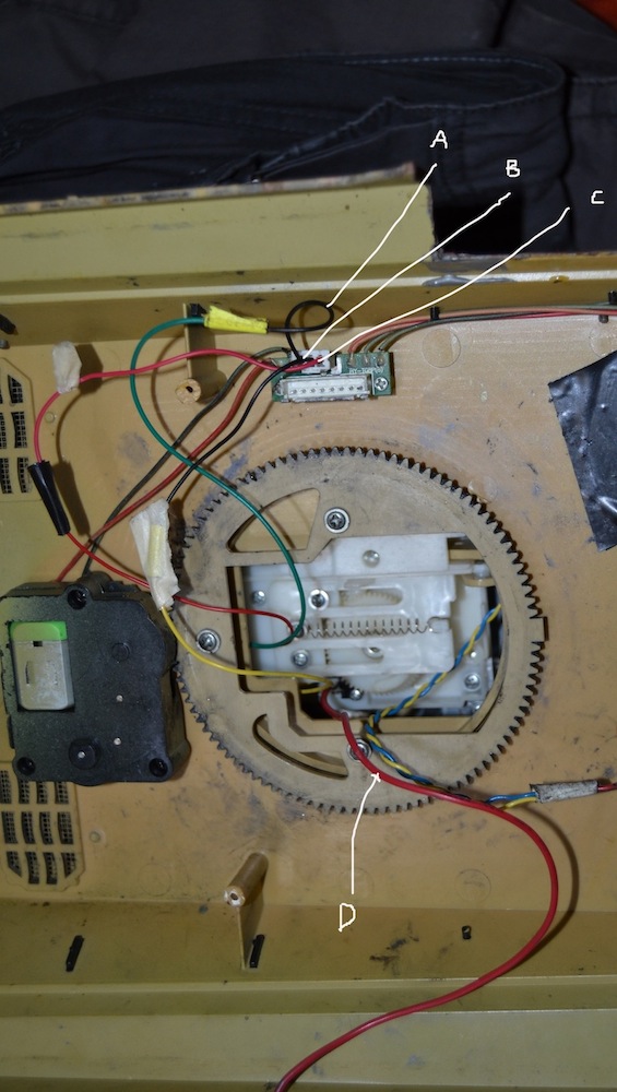

I found using one of the little Heng Long volume controls (or similar type) you can wire one into the negative ground wire (red color)
coming from the recoil unit to adjust the gun return recoil speed and use the same thing (another one) to wire into one of the motor leads on the turret to allow turret rotation speed adjustment.

Yes stock recoil unit.. the spring pulls the barrel back and then the motor returns it..Dan Crowley has a tutorial with resistors
but I found easier and adjustable just to wire that little pot into the one wire and no need to even open up the turret! The adjustment on the dial is very small for turret and recoil so you just need to play with it for a min to get it set how you like.

I wired the volume control/pot into wire "D" the ground wire from the turret going to recoil unit (stock Heng Long) Very simple
and you can tweak the recoil gun return speed. Same thing for turret motor for turret speed.
