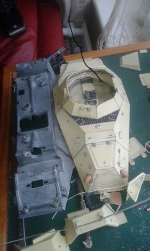

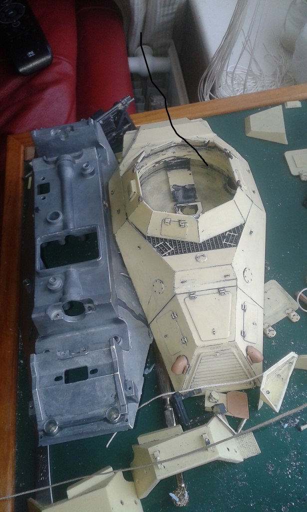

Having always fancied a 222 I managed to aquire one that had been to put it bluntly been built badly, a few others had had a go to try and sort it but realistically it deserved better so a complete strip down was needed, Id seen it running at a MAD meeting and it struggled to cope with inclines though it was way to quick.
Another thing that had to be addressed was access to the internals, a friend 'Famo man' has a 222 and was infuriated by having to disassemble the whole thing to get in to make adjustments or change a battery so with this in mind I set to work stripping the whole thing down.
Once apart I soaked all the parts in Mr Muscle to soften the paint and it lifted off all the metal parts a treat but took a little more effort to get it of the resin parts.
The following picture shows the basic parts after initial cleaning, you can see the turret simply sits in the upper bodywork so I decided that id open it up and ad turret rotation

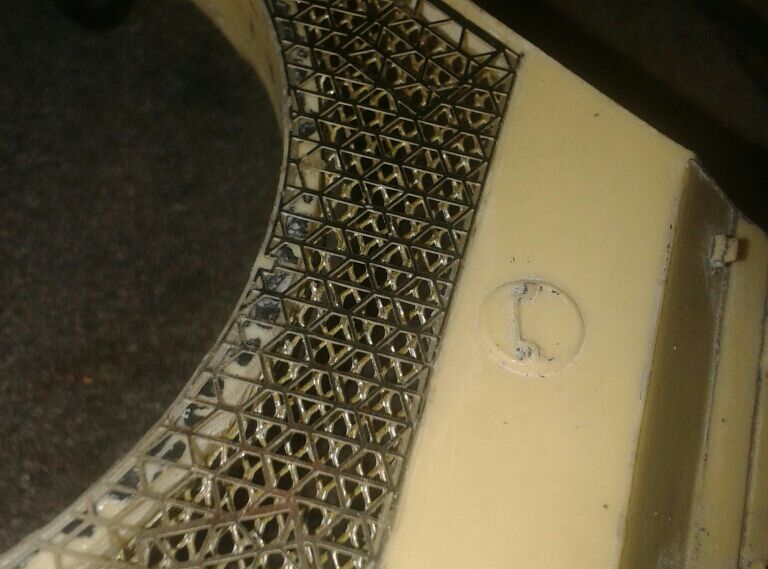

]I cut the recess out with the dremel and also the grating at the back of the turret. I had the pe grill to replace the cast grill and it would look so much better.
Phone download Aug 2015 827.jpg (64.6 KiB) Viewed 4248 times
It had to be recessed a little so a bit of careful scraping with a scalpel blade gave it a nice recess to sit in.

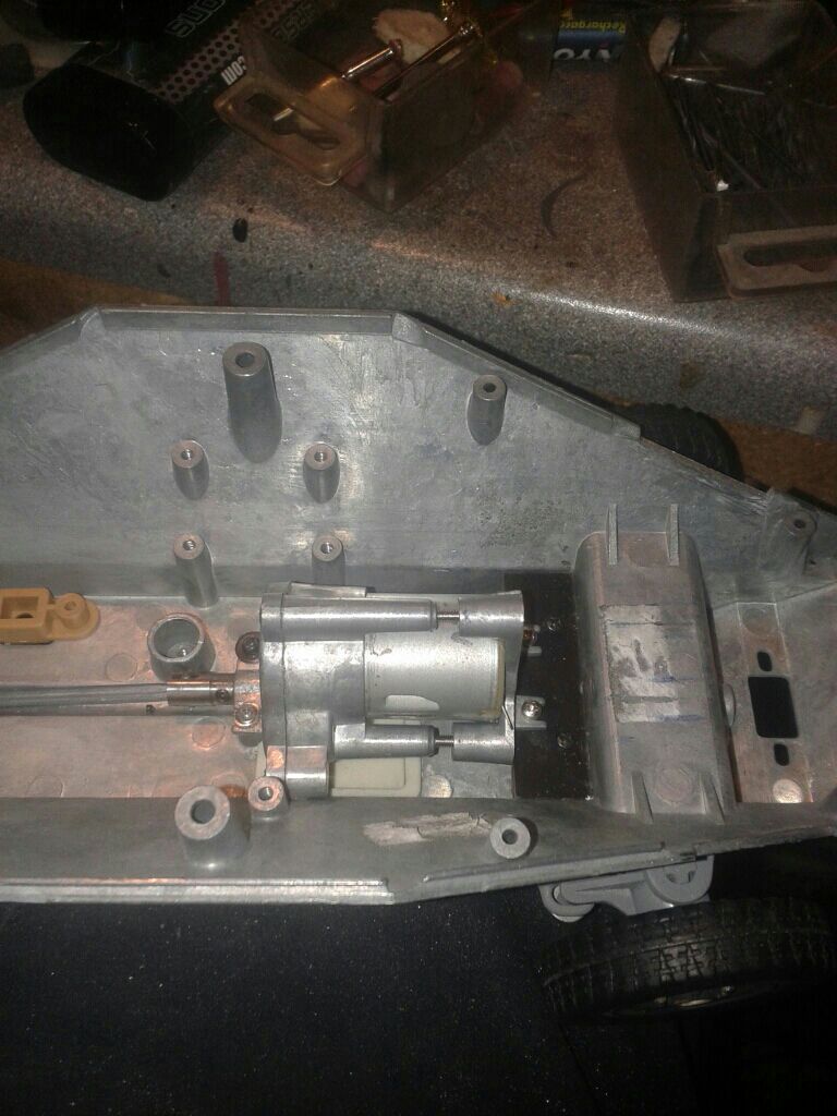

Space is at a premium inside a 222
Phone download Aug 2015 709.jpg (34.01 KiB) Viewed 4191 times
The gearbox is designed for a 280 but it needs more torque and less speed

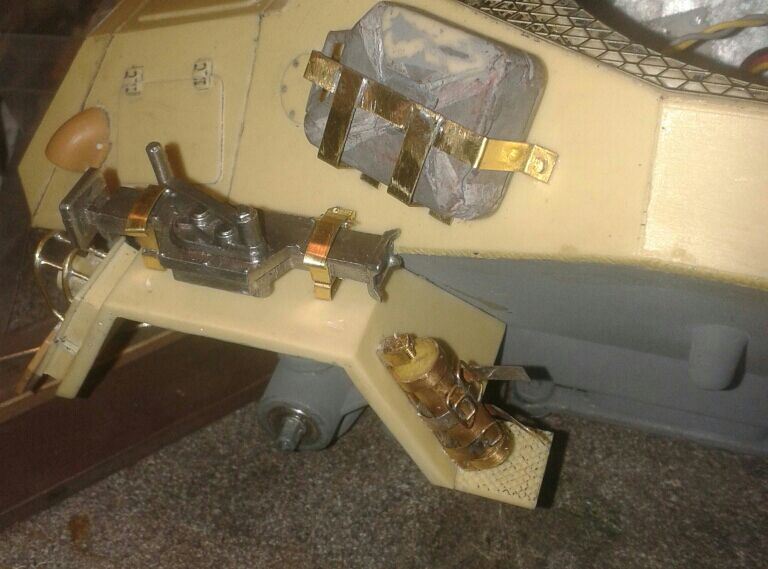

I fitted a led into the front Notek and made a brass cage to fit over the top and some hex rod cut to represent the bolt heads
Phone download Aug 2015 859.jpg (50.66 KiB) Viewed 4163 times
Phone download Aug 2015 871.jpg (50.96 KiB) Viewed 4164 times
The rear brake light was next which was made from a led that was cut and filed and a case made from milliput
Phone download Aug 2015 858.jpg (61.41 KiB) Viewed 4164 times
Next a brass cage to fit over that
Phone download Aug 2015 870.jpg (46.87 KiB) Viewed 4164 times

The rear convoy light was next, four mini leds all wired up and mounted in milliput and the brass step.
Phone download Aug 2015 923.jpg (47.1 KiB) Viewed 4159 times
With all the lights the brass cages are a necessity as protection from knocks and scrapes so they are all mounted solidly in the resin
The mudguards have all been hollowed out a little to better represent the sheet metal they are made from, the original resin wings are quite thick and not quite the right shape as they come out of the box the kit is a modellers joy and is easy to improve but it isn't a straight out of the box screw together kit

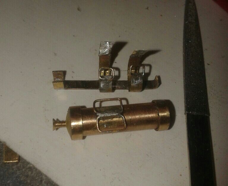

Bit of fun scratch building the fire extinguisher and its mount
Phone download Aug 2015 891.jpg (53.57 KiB) Viewed 4159 times
Phone download Aug 2015 875.jpg (44.73 KiB) Viewed 4159 times

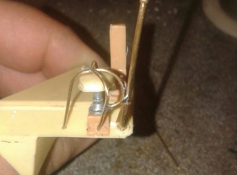

Next the jack cleaned up and a few little details added and its mounts.
The stowage loops cast in resin have been cut out drilled and brass wire inserted to make them serviceable.
other little details
Phone download Aug 2015 924.jpg (70.17 KiB) Viewed 4158 times
Phone download Aug 2015 920.jpg (70.26 KiB) Viewed 4158 times
Phone download Aug 2015 919.jpg (60.69 KiB) Viewed 4158 times
Phone download Aug 2015 918.jpg (64.09 KiB) Viewed 4158 times
