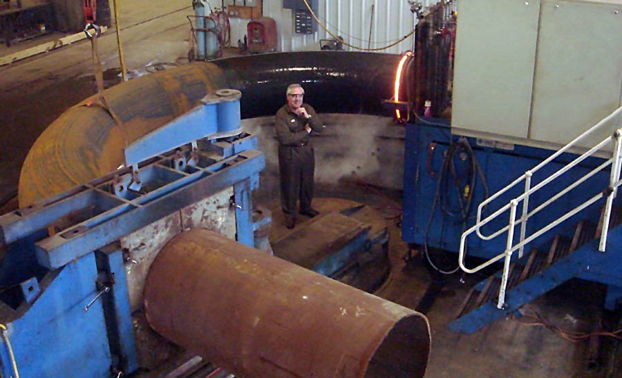

Just get one of these off Ebay, with any luck you will get free postage.
- home_image_02.jpg (67.32 KiB) Viewed 867 times
