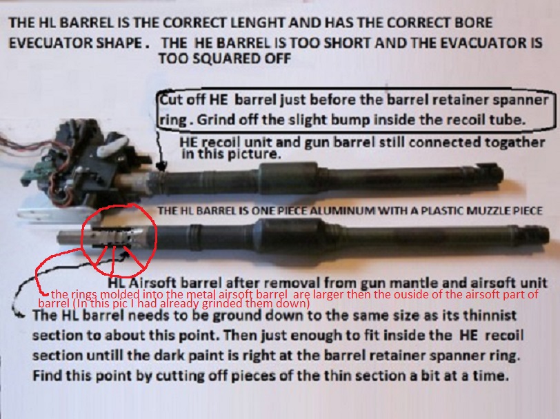

The barrel has a if I remember right, 2 or 3 rings machined into it that the mantle appears to be molded over.
Same careful work with a small hot iron or Dremel tool burr or possibly heating the barrels airsoft end and pushing the barrel toward the airsoft unit side of the mantle may expose the rings ( so the outside of the mantle isn't deformed) enough that you could grind them down to the airsoft size then pull it out the front the mantle.
I ground enough plastic out that I could see the one ring from the rear but the inside of the mantle in front of the 1st ring you see ring also must ground away.
Unless you can grind the ring/rings down to the airsoft part of the barrel size I don't think you can get it out without ruining the mantle.
Mine frustrated me so much, I ended up heating the barrel to much and the HL mantle deformed when I tried to push the barrel back to get at the rings to grind them down. :thumbdown:
Lucky I intended to use the HE recoil unit so I just used the HE mantle ( It is a little off detail wise and some trimming needed to be done on its bottom edge) but it did fit right into the HL turret.
This pick may give you an idea what your dealing with.

If your willing to risk the one you have try the heating of the barrel by using a soldering iron and pushing the barrel back into the mantle just a bit at a time as the plastic softens, then stop and remove any plastic that moved around the barrel and repeat until you can see enough of the barrel and remaining plastic to be able to grind enough of each off so the barrel can be removed.
If you look at my build thread ( there is a pic of the HL mantle that I ruined alongside the HE mantle I ended up using ) you can see that I tried to heat the barrel hot enough to pull it out all at once, which messed up the mantle front where the hole for the barrel is.
