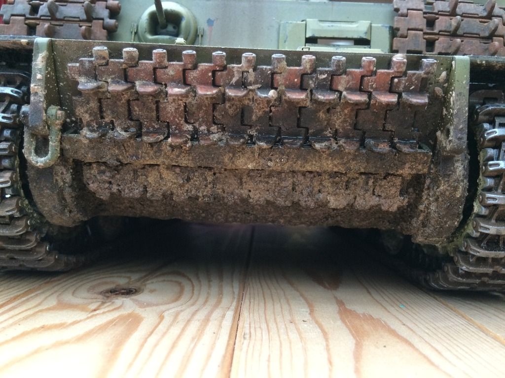

Thanks. I'll have to check the tracks. They are not loose you see. They have been painted so some might be stiff.
That's why I thought maybe if I run it on carpet inside the house for a bit, they might loosen? I have changed to a single 4000 lipo now so I'm hoping that's saved some weight compared to 2 x 1700nicad packs my brother gave me.

They look a little slack. They look like the real thing but for a model need more tension.
Powder snow is fine. Wet snow will destroy your entire running gear, tracks, wheels, idlers, the lot. It builds up in the idlers and gaps in the wheels and will either detrack the tank or bend/break pins. It will also put stress on the axles and hull as the track stretches.

Thanks. So if I do come to the conclusion that it's slack, how do I tighten it? Take out a link or is it the idler that I need to look at?
