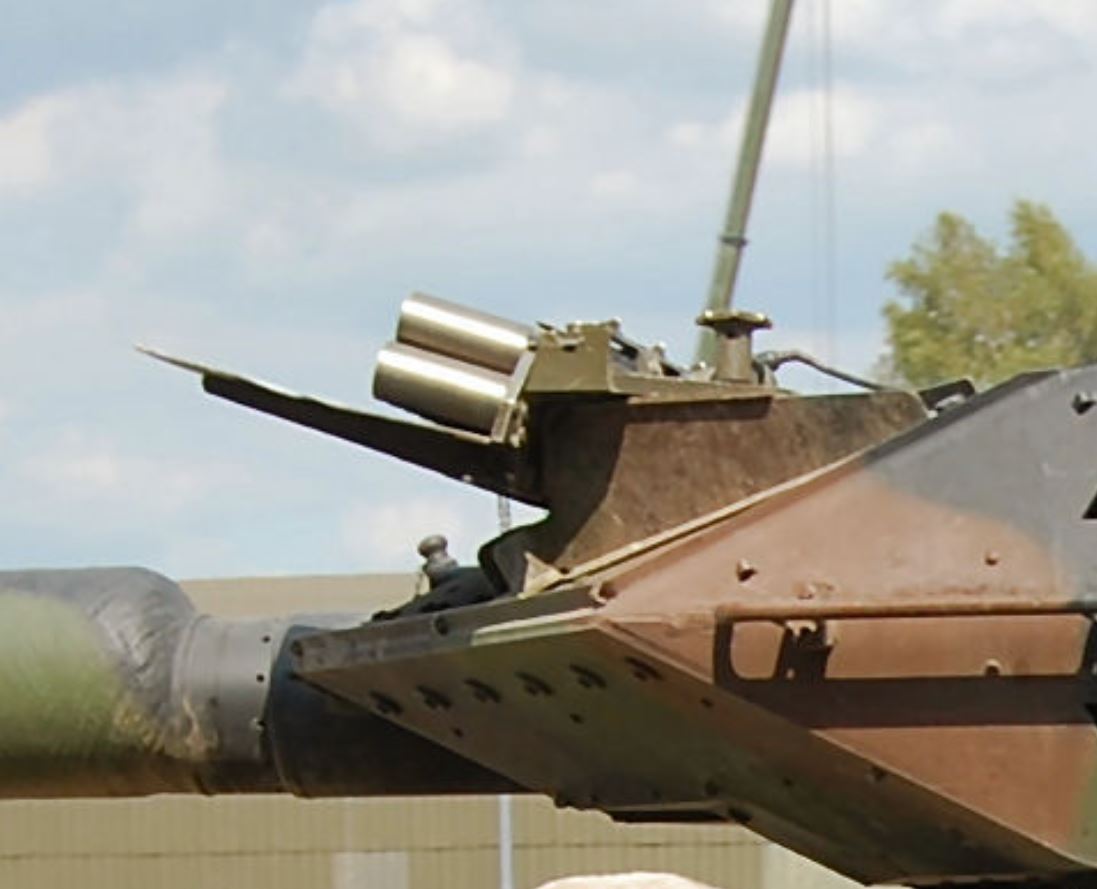

I found some pictures on the net already:
Seems to be there are some different versions...

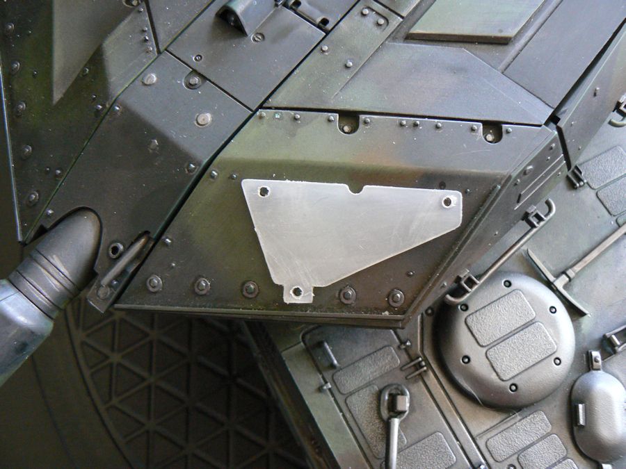

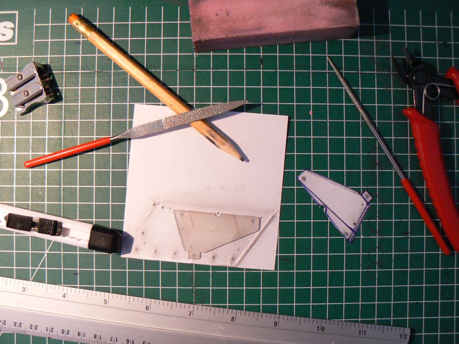

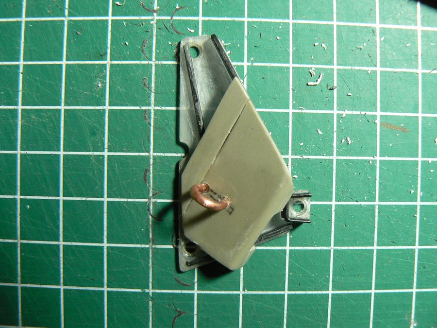

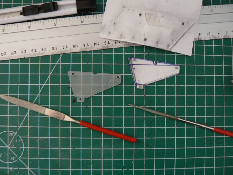

OK, here we go.
First try to make the darkas unit from scratch myself...
I don't want to cut the bolt heads off the turret so I drilled little holes in the base plate of the Darkas to fit over them.
To get the exact location I used a piece of paper and rubbed over it with a dirty finger.
(I don't think this is correct English, but you'll get the point I hope)
It's fun to do. :D
To be continued.

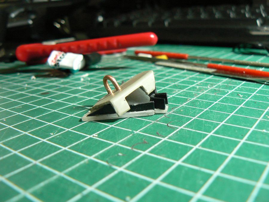

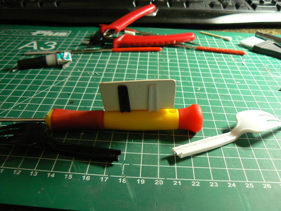

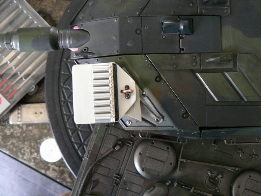

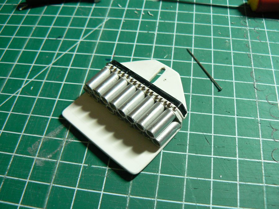

I changed some pictures in one of the above posts.
An update regarding my little Darkas poject...
Used only things which I found here at home.
Some plastic strips.
The pipes are made of 5mm blind rivets. (just removed the pin)
The inside was too small so I drilled them out.
I used two plastic forks, a piece of 2mm electric wire for the lock and some pins from my wife.
It may not look a 100% but so far I'm happy with my first scratch project.
Some Milliput and paint to go...
To be continued
