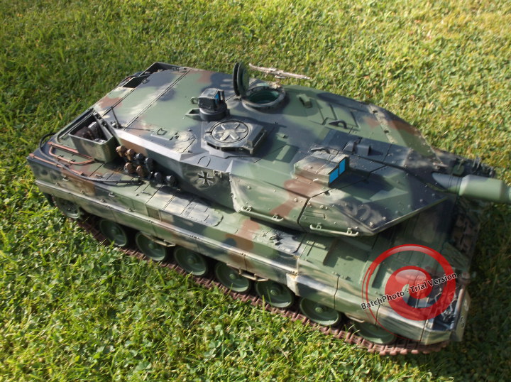

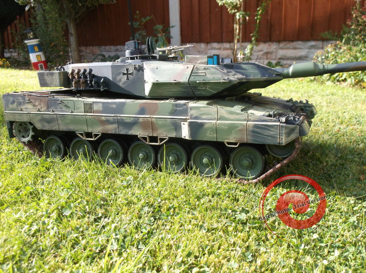

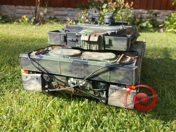

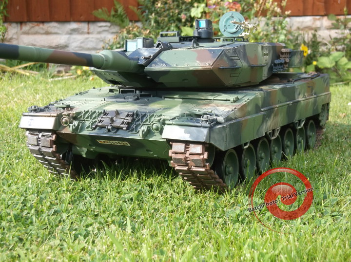

Thanks guys, will try " re bind", I have started the "add ons" [as you do], additional turret machine gun, dust n grime, rusting up the tracks etc. Ive just got to get the hang of the picture uploads as my files too big, so will post as soon as sorted.
Re: Leopard 2 A 6 2.4ghz
Ok, sorry about the watermark on these files, but at least its a start till I source another program to re size the images.

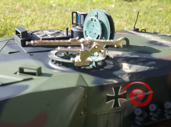

The machine gun was purchased from "Tank zone" and its a superb detailed casting in brass,.
