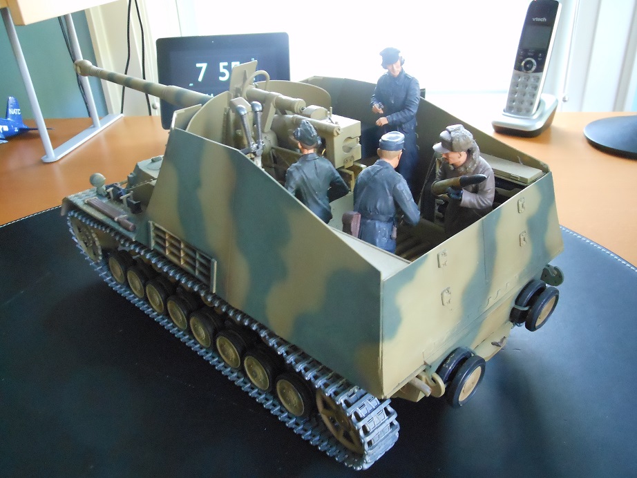

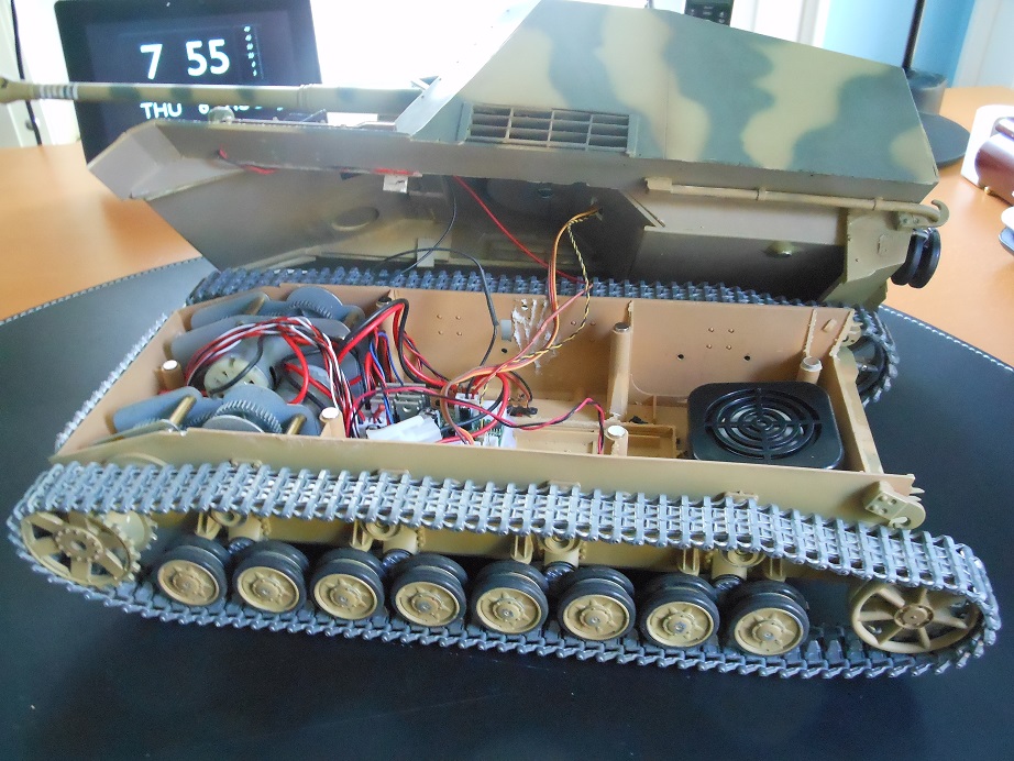

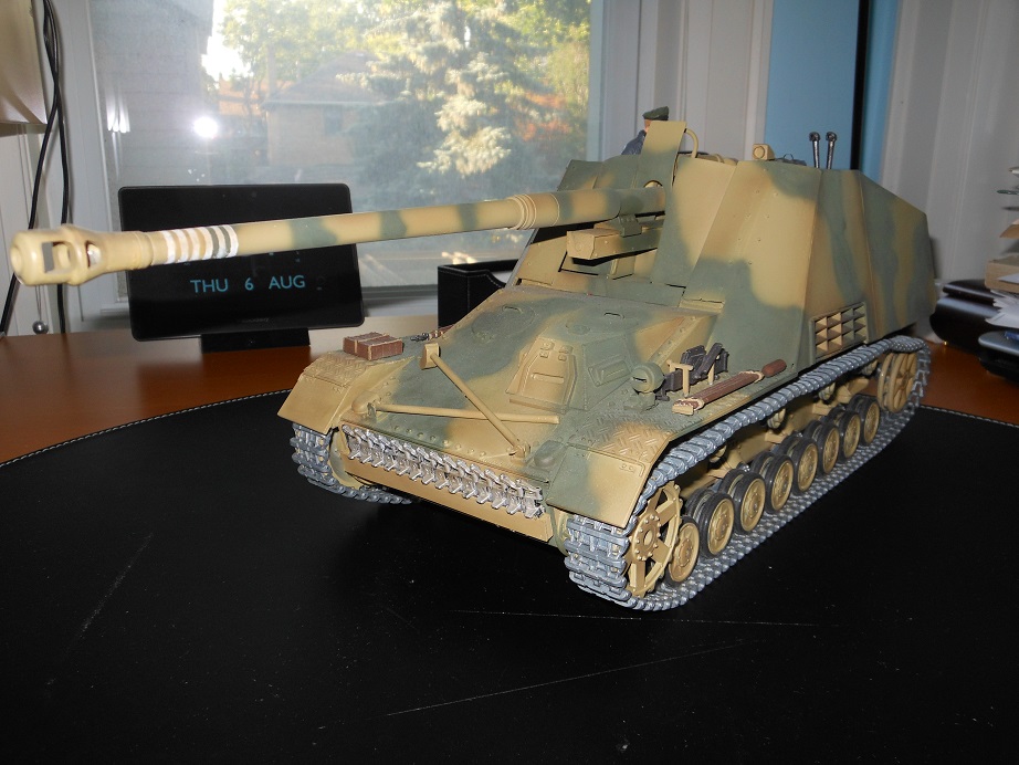

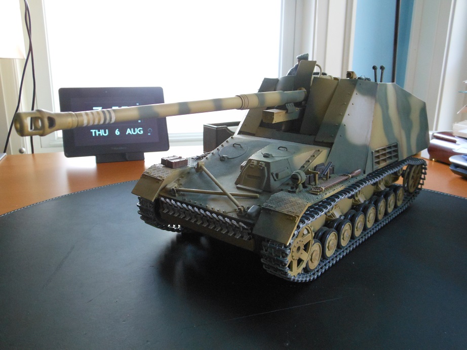

I have built his Nashorn/Hummel a while ago and here is the thread:
viewtopic.php?f=33&t=11907&hilit=nashorn
Here are some updated pictures and as you can see on the last one, it is simply a Heng Long bottom with Clark electronics. I even share this lower with a Heng Long PzIV. I just have to move the end plate to the Pz IV upper since the Nashorn/Hummel has a cab in place of the back plate. Disclaimer: I am a fanboy of Juck's stuff but I hope this helps.
