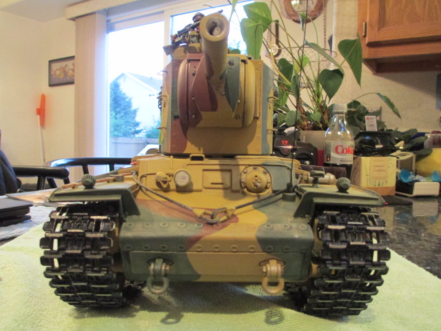

Did I do a Kv2???????????????????
OH Yeah....I did
One of my favorite tanks...modded to 2.4 gig...my Heng Long Blizzard Buster Gigant
Resin Turret (OOP)...The conversion was worth the effort....So just do it
As Painless mentioned...the conversion is basically the turret....few other little details like deciding if you want to keep the added armor both Taigen and Heng Long have on the side bulkheads...I took mine off...Warning though...there are huge openings that need to be filled if you do so
OH Yeah....I did

Thanks Ed...I agree...the KV2 has an awe inspiring silhouette...too bad there is no longer an archive of the build...it was fun fabricating the bits in order to get the finished product ...I think on this board..that photo is the last surviving image ...and it really doesn't do the tank justice
