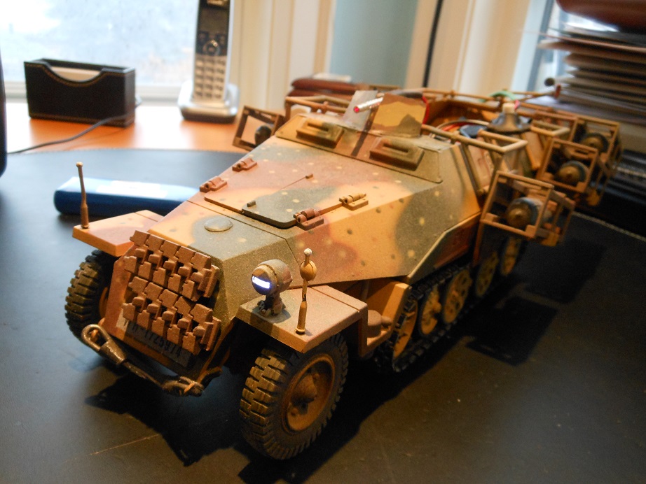

Here is a pic. You can't really see the tracks, but the headlight is hooked up as well as the MG using Clark board and Vs 1/24 Tiger I gearbox with Asiatam 251 metal tracks. Since I am using the Clark board it can be driven like a tank, and I didn't put in a servo L/R on the front wheels.

How well do the 1/16 tracks fit the 1/18 truck? Also how did the 1/24 scale tank gearbox work for you?

jack, the tracks fit fine. I sold it already but I can try to get dgsselkirk to make a video and show you (I might have one somewhere but will have to look). I didn't put in the rubber pads because then it rides higher than the front wheels and I didn't bother with it. If you are re-doing the front as well then you would have to lower the front axle. The reason for the 1/24 gearbox is because of the width of the chassis, too narrow to accept even a mod Heng Long gear box.
