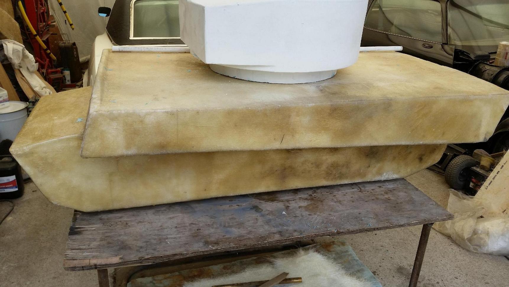

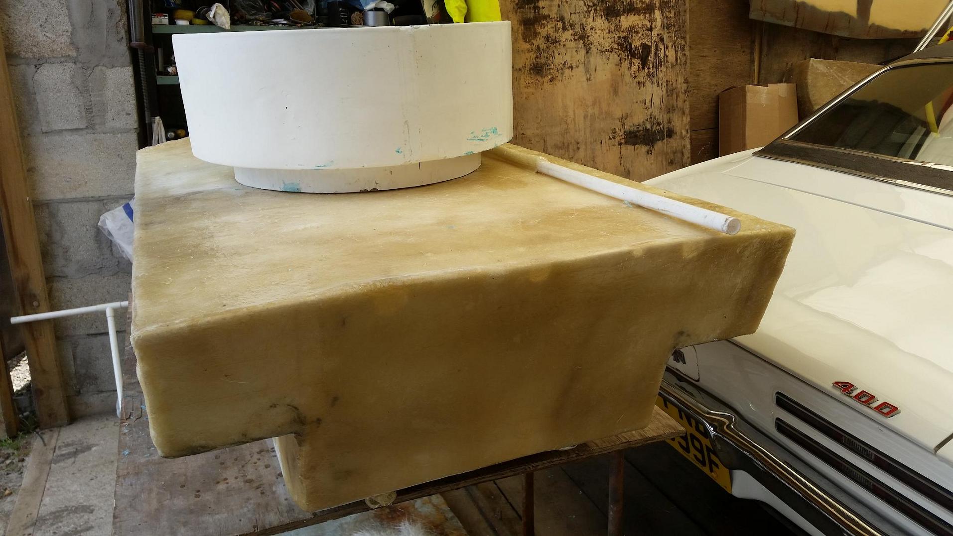

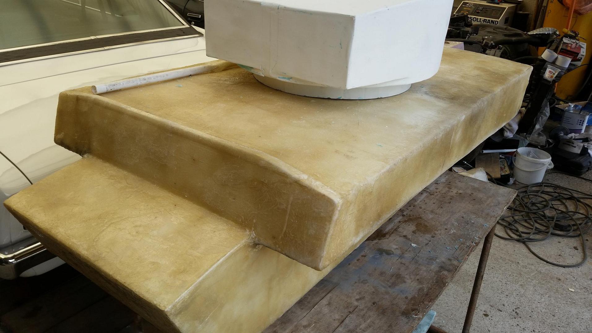

OK I've started making this Tiger tank for the Grandchildren to drive around in, the hull and Turret will be in Glass-fibre, so that I can make them one each, I have so far made a basic Turret shape mould and I will add more detail and the main gun mount next and then add those as I make them.
And I have also made the mould for the hull, which I need to decide where to cut so that I can empty it and start making the basic Hull top and bottom, and then add more detail as with the Turret, I will be getting some colour pigment to go in the Gel coat for the next casting, as I don't like the white on the Turret I cast first time to see how it came out.
The turret will be motorized but I've not decided on the gun elevation yet?
I'm thinking on different design's for the suspension, I,d like to use air because its easy to adjust, but I may just use spring or rubber.
The wheels are my next big problem, there are a lot of them and they will be slow to make :(
Drive motors are for a Wheel Chair on 24v
I've tried to include pictures but they are too big so I need a child to show me how! and then I'll put up some pictures.
OK I think I've got it :)
Base Hull mould (before cutting the top off)

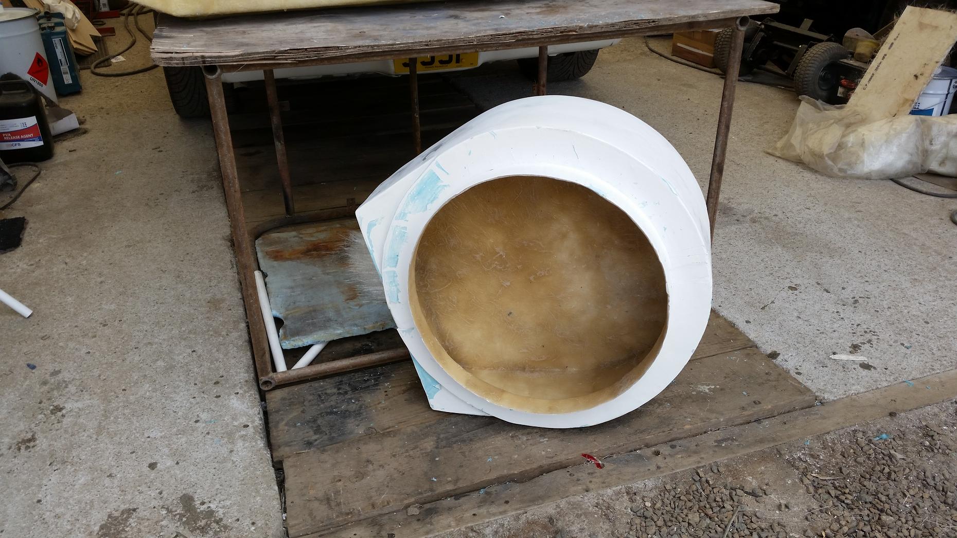

Underside of basic turret.

1/4 scale? Try go kart wheels or scooter wheels you may find some close to what you need. I would think a late model Tiger with metal road wheels would be easier to do then the rubber rimmed early or mid Tigers. Any thoughts as to the tracks yet? I would think they'd be the biggest hurdle. Maybe Bobcat tracks would work? I realize they'd be all rubber but this way the kiddies shouldn't hurt the sidewalks or grass too badly. But you look like you are off to a good start! Keep the pics coming. :thumbup:

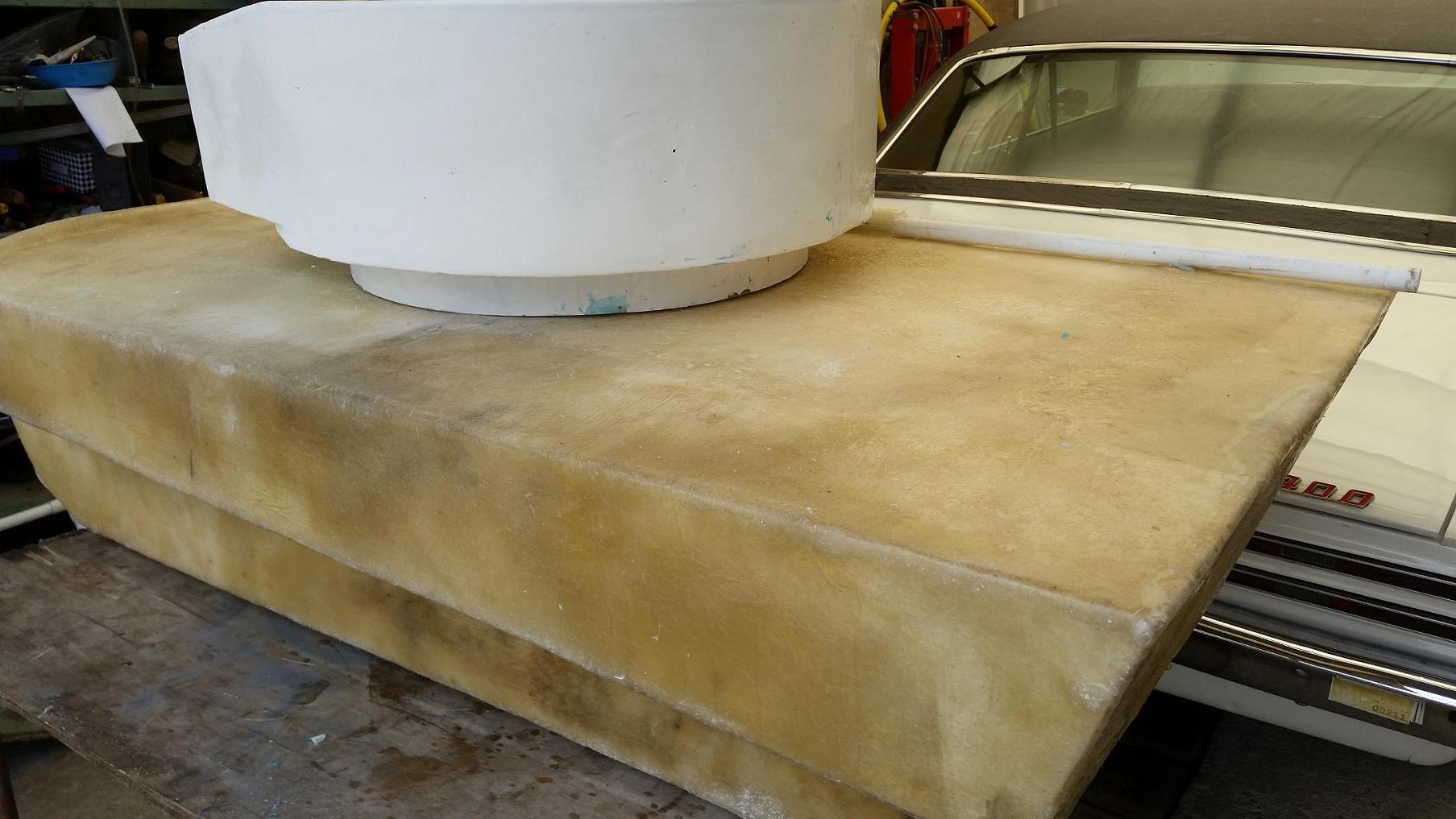

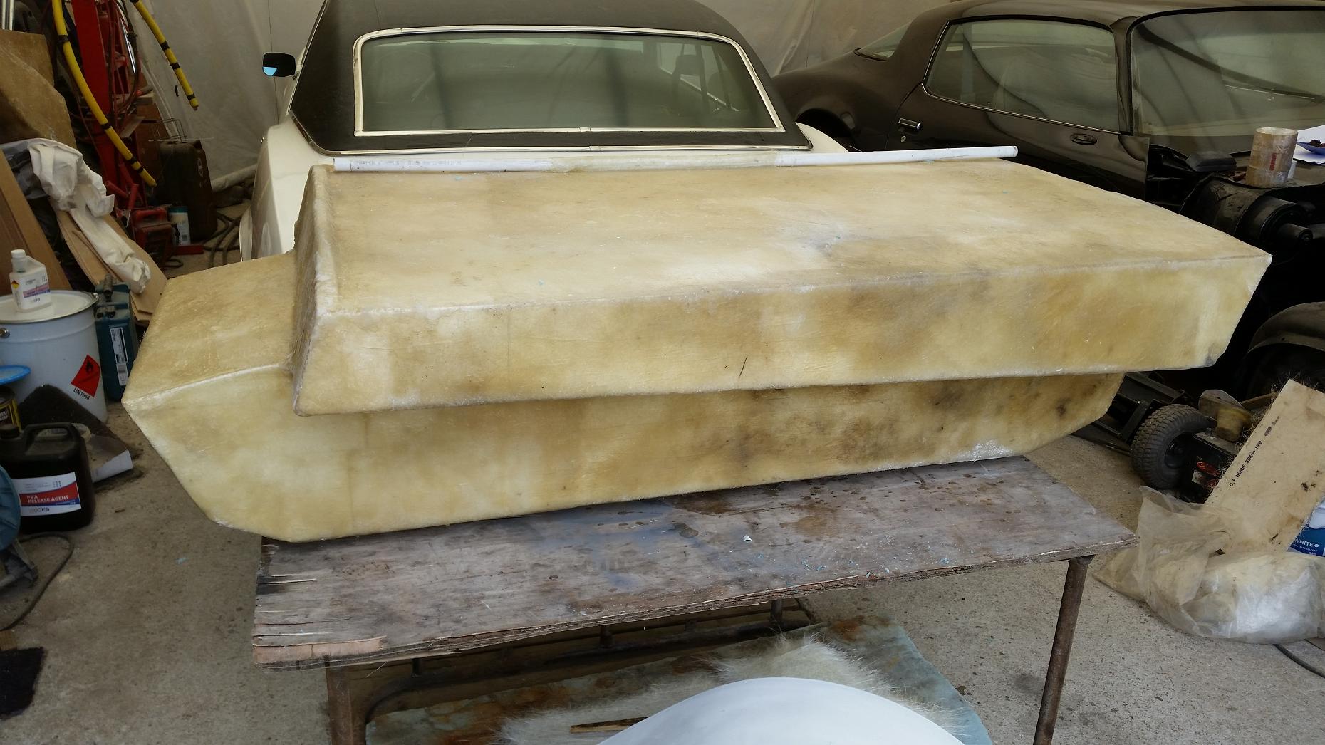

A couple more pictures :)
