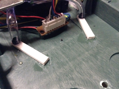

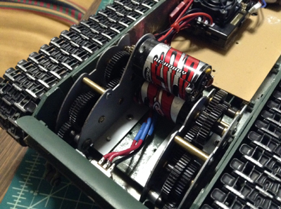

Taigen 4:1 have same 3 mounting holes as HL's 3:1, The taigen KV has a mounting plate for the gearboxes -to clear the torsion bars. The 4:1 are High/Low vs the stock 3:1's Mid/Low motor mounting. The left exhaust smoke outlet fitting with hose "will" hit the High (left) gear box*. I nibbled around the motor area of the gear box so it is the same height as the motor and used hollow rectangle styrene with the cut nipples to move things (I did both but only one side is needed):
Don't have picture of "nibbled" gearbox but you can see the area that is higher than the left motor that is contacting exhaust fitting:
OE
OE
modified
modified
My advice if looking for realistic speed: even with the 4:1's the KV's sprockets (large dia) give a pretty "tall" overall ration, so use some low rpm motors, I'm using some high performance 380's that are 70 turns that are used in a rock crawler - I paid too much for these (30+ea)...after finding these: 11K rpms: http://www3.towerhobbies.com/cgi-bin/wt ... LXVFJ8&P=6 8500 rpm: http://www3.towerhobbies.com/cgi-bin/wt ... LXVFJ7&P=6 and 5000 rpm: http://www3.towerhobbies.com/cgi-bin/wt ... LXVDV1&P=6
I bought 2 8500's to test for future builds.
On a side note: I like the High/Lows there are NO hard to get at screws!
