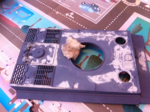

Its underway a basic heng/long upper hull butchered
Some escape hatches I bought by accident put to good use!?

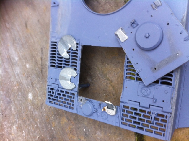

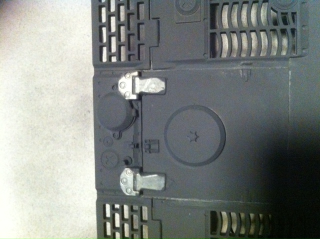

I fitted a tray on under side to stop hatch falling through gap and also to thicken out where hatch was cut out works ok
Now at this point I think Im a right clever clogs, but glue has seeped into the hinges and it wont open lol, i'm brand new lol

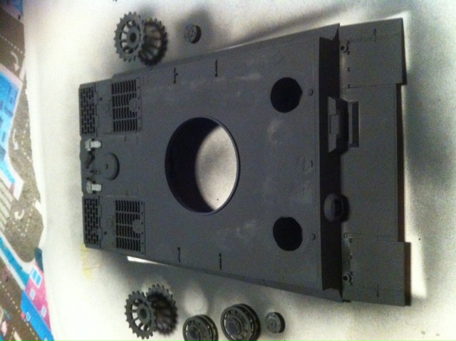

looks cany but need to fine fill a bit more
caulked ready for some paint

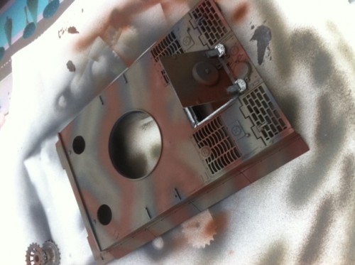

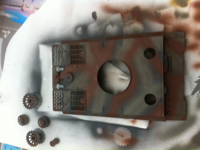

:silent: I had a spare hour or two so managed to loosen off hinges using the wifes nail varnish remover. I also done some fine filling re-painted base with German grey. I then experimented with some paint colours, basically I've tried to show that with the war in the latter stages the gerrys had limited colours and quality. So I mixed German blue with green and with the brown, it kind of looks like a paint scheme I've seen but I cant remember which battle???
Hatch shut sits like a bot on a pot
photo (5).JPG (96.52 KiB) Viewed 3071 times
Hatch opens woop whoop I'll be putting the on off switch in there me thinks

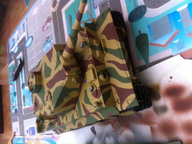

Here's my first tank that got me hooked
colours look to rich but a good first attempt

Blitz, Hi, If you want to keep on the right side of your lady's temper I would suggest you go to your nearest Hobby shop or go on-line and buy"ZAP7" which is a debonder and it eats superglue.It is marketed by "RIPMAX".
You probably know, but if you don't there are two types of debonder ,
1/removes parts of your Tank from parts of your tank.
2/ removes parts of your tank from YOU.
ZAP7 does the first very well. Apply it liberally to both parts and wait a couple of minutes then gently ---for goodness sake GENTLY!!! :O Move both parts to ease separation, once they are apart clean all surfaces of debonder. :thumbup: shaun

Mr Jarndice is bang on with the de-bonder. The super glue I use normally has a co-produced glue de bonder available in a twin pack. Moments of (ahem :{ ) artificially created absent mindedness can cause a grab for the wrong stuff at a most awkward moment. :problem: The stuff has the same look on the tube.

BLITZ Hi, I know you say you want to put the power switch under the engine hatch, might I be allowed to suggest an alternative? If you look at the Hull from the front, on the upper side of the support wings/fenders on the left are two small predrilled turrets which are ready for the power switch to fit, If you use this point you can easily access the switch by opening the Radio operator/Ball Machine Gun hatch, If you look at TAIGENS Tiger1 you will see that the Factory fit their power switch here. If you fit a "TARR" smoker then the engine bay hatch you have fitted would provide perfect access to refill it when needed :thumbup: shaun
