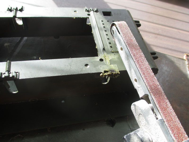

I have finally got round to starting my Firefly I have been told by guys that know more about Firefly's than I will ever know that to do it right it has to be 28mm longer so the hull will have to be cut up and lengthened so here we go. I got the Mato hull off Frank thanks mate I hope I do it justice
No going back now

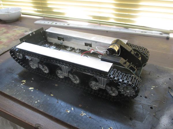

Done some more work put the hull together using 2mm aluminium sheet I couldn't get the folds in the correct place I was 1mm out so had to cut the one side to make it fit properly I used the mato metal wheels and T49 duckbill tracks for something a bit different the last picture you can see the difference in length from the normal Sherman. This thing already weighs 3kg without electrics of top hull I hope the mato gears cope.

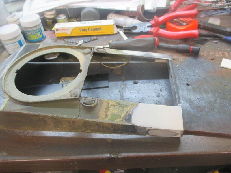

Got some more done painted and weathered the bottom half of the hull as well as start the build on the turret I am using the hatchette metal hull parts I got earlier this year then adding what is left by scratching the parts. I have also lengthened the upper hull.
