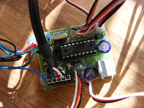

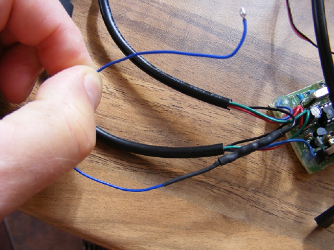

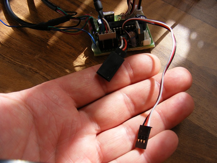

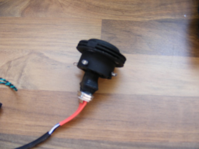

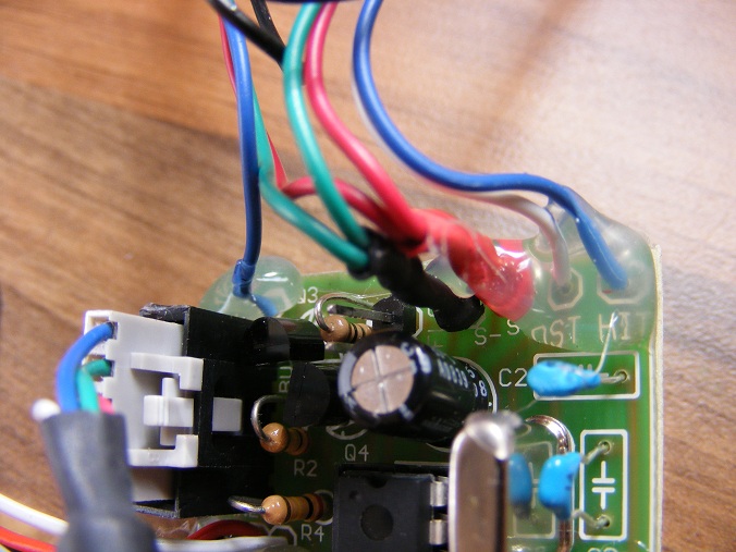

Well the DBRC 2 turned up the other day, right out of box everything looked good :thumbup: . Well packaged and well made electronics. the only gripe I can think of is no hard copy of how to connect up to an RX 14/Rx 18 board. I know you can go to either Darkith's or RC Tank Wars sites for set up downloads and such but there is nothing specific on what wires connect where. Saying that most things are very straight forward with the apple connector wires having only one five pin socket they will fit into as well as a two pin socket for the LED connection. The four Futaba style connectors for the RC reciver are self evident. However there is a single blue wire coming off the sound boards ( I'm assuming this bit is correct ) which connects into the HL speaker system if I'm reading the Darkith instructions right. There are also 2 Futaba style connectors on the board for I assume an extra servo function if wanted/available . As I say not a lot of info on those two things for an electronic ignoramus like me :haha:. So not wishing to make a c*#k up of anything Ive taken some pictures so that those in the know can say "the blue wire goes there and this is how you connect up that extra servo you numpty ". So without further ado PICTURES

connections for fire,hit,destroy and flash
DBCRC 007.JPG (124.44 KiB) Viewed 1032 times

The board
DBCRC 001.JPG (136.2 KiB) Viewed 1032 times
The  " apple "
The " apple "
DBCRC 005.JPG (74.25 KiB) Viewed 1032 times
The " extra " servo connectors ???
DBCRC 004.JPG (145.37 KiB) Viewed 1032 times
The blue wire !!!!!
The blue wire !!!!!
DBCRC 003.JPG (143.27 KiB) Viewed 1032 times
